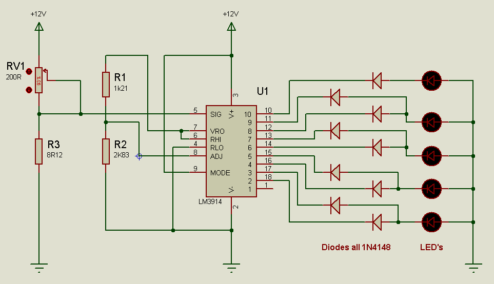

ahhhh okay so ita all hooked up and works...kinda....i cant figure out what i need to do to get the clibration correct....it will light up and as soon as i connect ANY resistance to the singal pin it turns all off, but i know it works becasue i can slightly toucht the signal lead and use my body as a resistor and can get what ever i want to light up.
SO how do i calibrate it??? i tried switching resistors out with other resistors but NOTHING...WHAT DO I DO?????? i need it to work from 12 to 132 ohms on the signal :( :(

With reference to the attached schematic.
I used the voltage divider rule and calculated a volt drop resistor of about 8.12 Ohm in series with the gas measurement device. (RV1 in the circuit replaces the gas sensor). I got a voltage of between 0.7V and 5V for a measurement range of 12-132ohm.
This is only for example. I don't know if the fuel you are measuring is flammable or not? (Diesel, Petrol ???). Calculate the resistor wattage to ensure that they don't heat up too much.
If you require a more precise 0..5V input signal, you will need to use an OPAMP.
The LM3914 will light a led for every 0.5V on the signal pin. Assuming a voltage level of less than 1 volt on an empty tank, the IC will start switching on the LED's as the resistance value of the measurement sensor decreases as the level increases.
The diodes in line with the LED's are all 1N4148 diodes. I did not include current resistors inline with the LED. You will need to calculate the required resistors yourself.

Will that work? He said the fuel sensor rheostat (variable resistor) has one side grounded internally and only the one lead available, so I don't think he can rewire it so as to have both terminals available to use as you have drawn.

I must have missed the one wire part.
I actually also have the resistor value wrong as well. It should be 8.62 Ω. (Good luck finding one with that value in any shop :p ).
8.62 Ω should give 0.7V drop across the resistor when the tank is empty and at fuel sensor measuring 132 Ω, the volt drop over the 8.62 Ω resistor should be exactly 5.0V.

ahhh its starting to make sense a little to me... but i dont under stand what wiring a 8.62 ohm resistor in line with ground would do for me, but if it will make all this work i can get a resistor in there , but it is atill just going to common ground.
as for the two resistors that it is using for ref, do those change now that you have changed the value of the one coming off the signal
It's dificult for everyone that is just starting out. I am also just learning the basics.:)
The resistor values for the ref do not change, they are just a voltage divider setting up a 5V reference.
