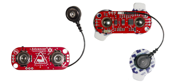

    Hi hope someone can help me achieving this build, i am a newbee in electronics.
    I am working with a research project in my hospital department, where i have to monitor the back muscle activity in scoliosis patients.
    I have to record the EMG activity 4 different places ( 4 electrodes/channels), for 24h for like a whole week.
    I have in mind to use an Arduino ( as small as possible ), some electrodes, and somekind of external storage, an SD card maybe.
    i have been looking around in the internet but almost all projects involving EMG sensors are single channel and not storing in a card.
    So please any advice on how i can approach the project ?, what will i need and eventually some suggestions about what i am intending to do.
    Any help will be appreciated.

    by the way i was thing about using myoware as my EMG sensor

    I would do it pretty much as you describe. This example shows how to use the SD card Library to log data from three analog sensors to a SD card. I would use the Arduino or similar configured as a data logger. The sample rate you use for your analog channels will determine how quickly you use memory. I haven't a clue how much memory will be needed for a week of data. Using the link above will get you started as to the data logger. I see the MyoWare Sensor as a good choice as it has the needed amplified output so should be easy to configure with the Arduino. You will need to figure out how much power the sensors and Arduino will require. I would power this all from a 5 Volt source so you will need to configure a power pack which is portable and offers 5 Volts. Why 5 volts verse 3.3 volts? If you record the RAW EMG signals the output will be above and below Vsupply/2 so that will give you some flexibility. Then it is a matter of making everything nice and portable for the patient as well as compact.

    Thats a nice advice .. thanks a lot, a quick question .. can i just use an arduino Micro with my setup instead of the arduino Uno. just to keep things compact ?

    My guess would be yes but this is not my forte. I have a few Arduino boards that were given to me over the years but have not done much with them. Most of what I did have as far as programming went away with an old computer that finally failed. :(
    I would just take the direction of the link or if you have the programming skills try programming a Micro.

    Yes.
    And ron is right about the 5VDC, so use the Pro Micro 5V/18MHz arduino (rather than the 3.3V/8MHz).
    And the Uno has a different bootloader/sketch download routine than the Micro, which confused me no end when I first used the Micro.

    Oops. Typo on the 18MHz.
    But thanks for the jumper info: I've never even noticed that bugger :banghead:.
