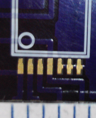

I am trying to hand solder a 6 pin sc-70 package to a professionally made board using a hot air soldering station. I've managed the SOIC8 and 14 pin devices no problem and managed a sot-23-6 but when attempting to solder the SC-70 package I managed to bridge two pins. I've removed the microscopic component from the board but can't manage to remove the bridge. Anyone any suggestions? Also, any tips in general on mounting these minute components very much appreciated.

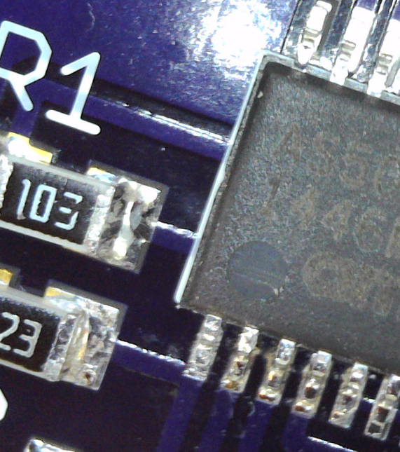

What size pads did you use? Mine were 0.012"x 0.039" (Eagle, approx. 0.305 mm x 0.991 mm). In other words narrower than on the MCP link you provided. Did you omit soldermask between the pads? Mine were soldermask defined (no central heat sink). I used leaded 63/37 solder.
Finally, for solder braid, I only use Chemtronics Rosin SD "Solder-Wick." I have tried other brands but have not been as satisfied. It will almost remove the very thin solder plating to reveal copper.

I figured a couple of images might help.
Here is the board from the Purple People:
Millimeter scale at bottom. NB: solder resist
Here is the soldered device (AS5048):
Sorry for the glare. It is the best I can do with my cheap photo"microscope" (Andonstar).
