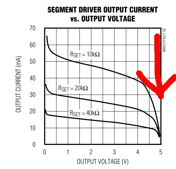

This chart shows the Vf of the matrices you have for your little blinker project. It can be as high as 5 volts.
The graph below shows the current drive vs Vf of the MAX7219. It falls to nothing before Vf gets to 5v.
Yes, you can design to the "typical" specification, but that runs the risk that the circuit won't work with parts that are within spec.

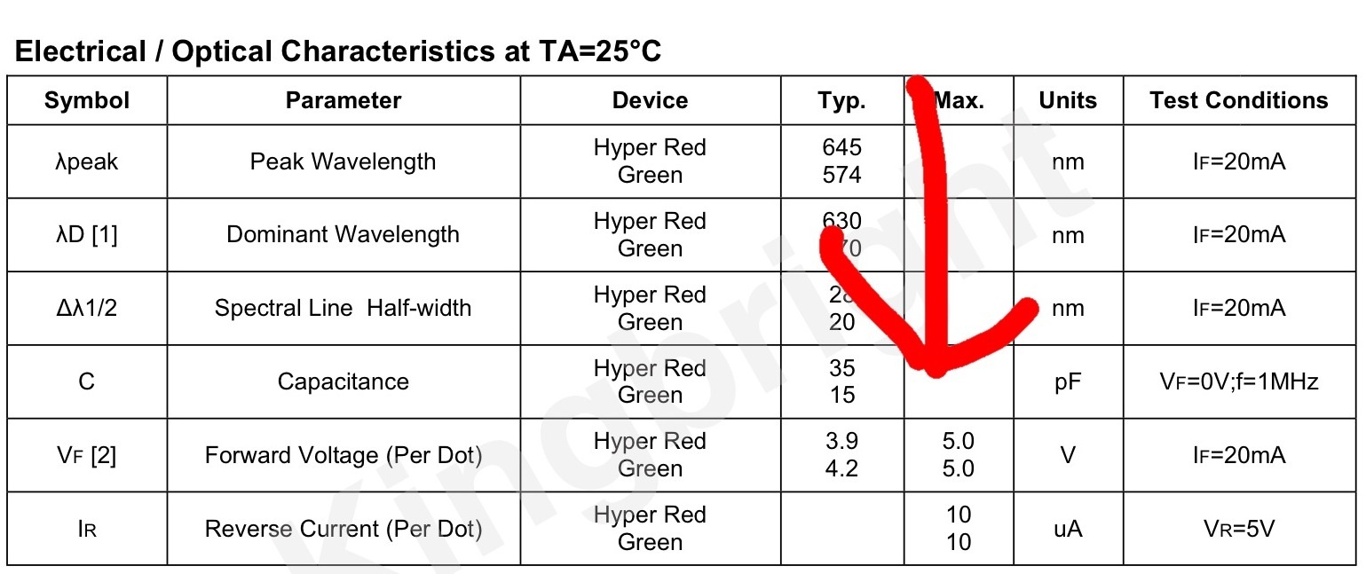

JonSea,
Where did that table come from?
Those Vf numbers are about twice what my experience with LEDs has been. Is that table for a special LED? Maybe one that has two series chips in one package?
I think Jon is referring to my 5 x 7 matrix I had planed to use.
The matrix that I had planed to use has two chips per color but am redesigning the matrix display since the one I was using had 650-700MCD diffused lens leds. Kingbright TBC40-12SURKCGKWA.
My new design is a scratch built 5 x 7 bi color matrix with 2000mcd water clear leds. Just have too many items on my plate until Sept 1st. to do any more with that project. Am using a constant sink chip on the cathodes and maybe the max7219 might be a better choice but will look at options after Sept 1st.
I can see where the Vf would go to zero using two chips in series. Another reason for different LEDs in my scratch matrix.
Chris,
The chart is for a large **broken link removed** MrDEB said he wanted to use. Each dot has two LEDs in series.

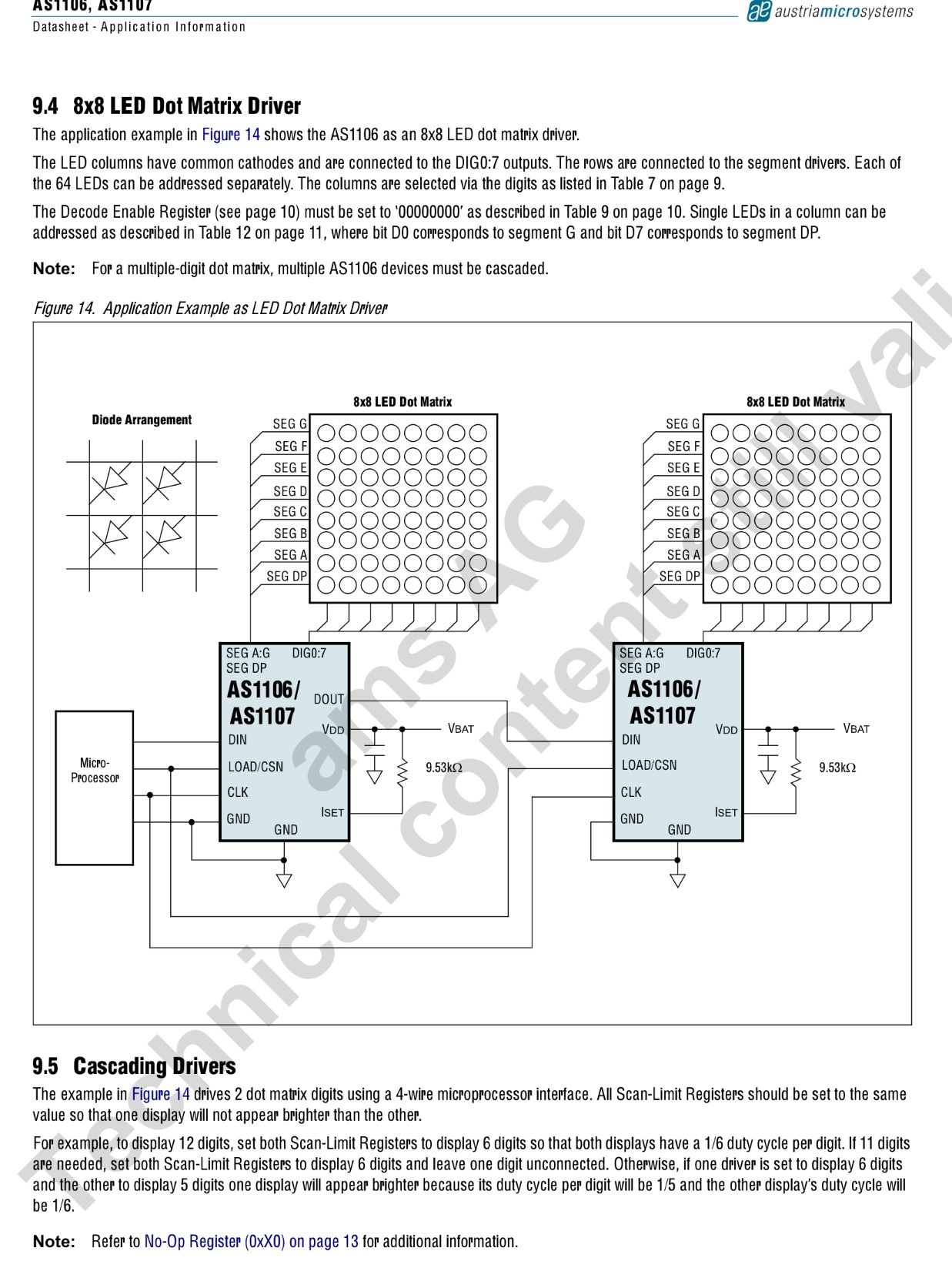

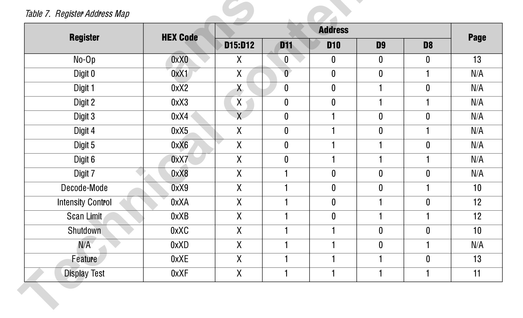

To start with, you must send data to several registers just to get the chip set up. Table 7 from the AS1106 (identical to the MAX7219 with a couple additional features) lists the registers of the chip. You have to set up registers 9, 10, 11 & 12 before you can make the chip do anything.
You need to set the decode register (9) to no-decode (%00000000) since you're using a matrix and not 7-segment displays.
You need to set the scan limit register (11) to scan all 8 columns (%00000111).
You need to set the shutdown register (12) to (%00000001) to turn the display on.
You'll want to figure out the intensity control resister too.
After that, the rest is easy. Send the data for column 1 to register 1, column 2 to register 2 and so on.
Read the data sheet. The AS1106 sheet is somewhat easier to understand. The only way you can make this chip work is to understand the data sheet. These chips are quite easy to use.

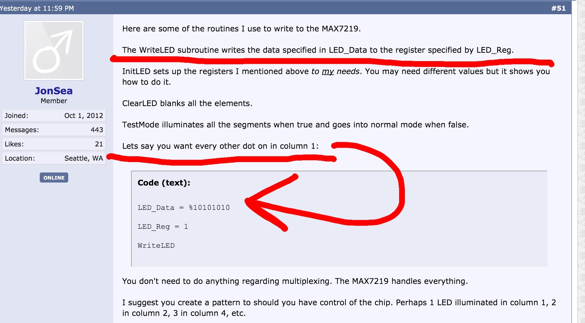

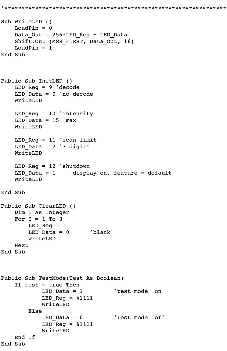

Here are some of the routines I use to write to the MAX7219.
The WriteLED subroutine writes the data specified in LED_Data to the register specified by LED_Reg.
InitLED sets up the registers I mentioned above to my needs. You may need different values but it shows you how to do it.
ClearLED blanks all the elements.
TestMode illuminates all the segments when true and goes into normal mode when false.
Lets say you want every other dot on in column 1:
LED_Data = %10101010
LED_Reg = 1
WriteLED
You don't need to do anything regarding multiplexing. The MAX7219 handles everything.
I suggest you create a pattern to should you have control of the chip. Perhaps 1 LED illuminated in column 1, 2 in column 2, 3 in column 4, etc.
(Sorry, no copying allowed – take the time and effort to understand the following.)
One final bit of help. The listing below shows the needed includes and variable assignments. Set up the clock/data/latch pins to the MAX7219 according to your arrangement – it may be different than mine.
Also note: the "digits" in the MAX7219 data sheet correspond to columns on the matrix, and they may run from left to right or right to left depending on how the board is laid out. The 8 bits of data you write to each digit register are the dots you want illuminated in that column. LSB – MSB may go from bottom to top or top to bottom depending on how the board is laid out.

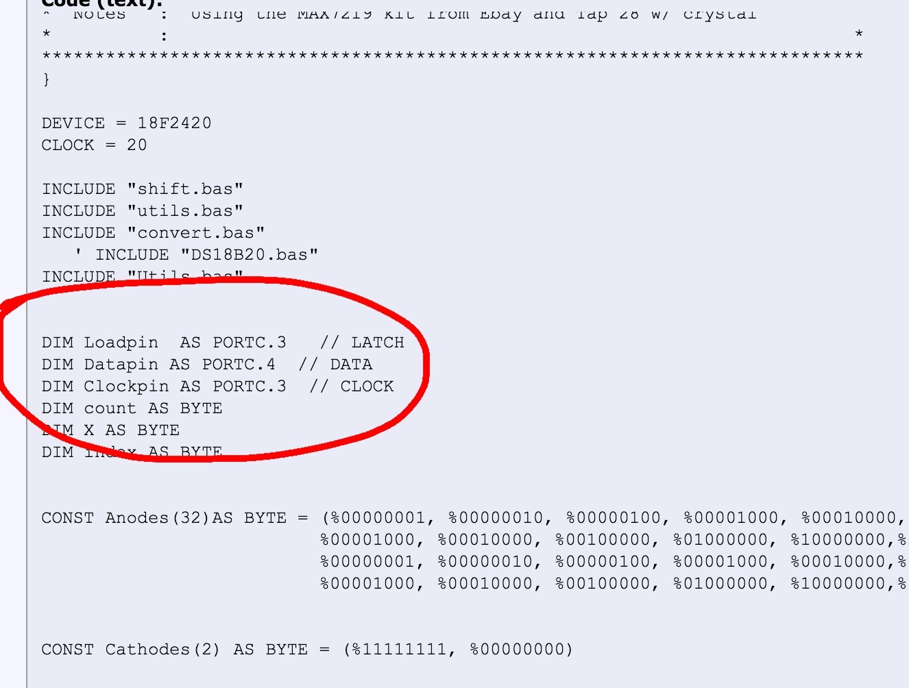

Nowhere do you assert the load pin, which is necessary to put the data in the chip....but....in the dimension statements you've set the clock and load pins to the same port pin, so you may be strobing the latch pin with every bit transferred. Some combination of the resulting junk may have turned on the chip.

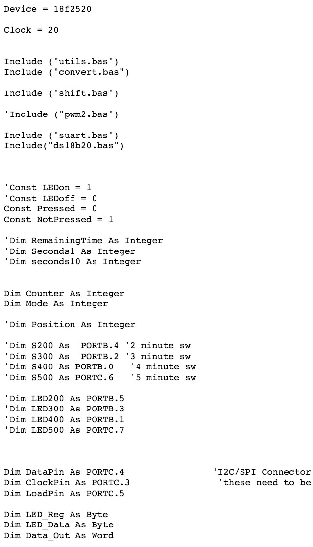

As I mentioned, I took a fresh look at the data sheet at 4:30 this morning and your posted 7 seg code over at DDIY and realized my error of not addressing the 16 registers properly. Also studying the Arduino code for same.
Arduino Playground - Max7219
....Deciphering the code you posted and the one you used for a 7 seg display both have the line of code with
Data_Out = 256* LED_Reg + LED_Data.
am I interrupting this as the method to input the option registers then the data desired?....
You have to write DATA to REGISTERS to set the chip parameters AND you have to write DATA to REGISTERS to turn bits on or off. DATA to REGISTERS is DATA to REGISTERS, as I explained above. Write the necessary DATA to the setup REGISTERS and the desired DATA to the data REGISTERS by
Setting LED_reg to the REGISTER NUMBER,
Setting LED_data to the desired DATA and calling
WriteLED
just as I already explained.
Please throw all of your existing code away and start over. Almost none of it applies to the MAX7219 board.
For your program, include the subroutines above. In the InitLED routine, you want no-decode, as shown, and you want to set the scan limit to 8 to drive all 8 columns.
Then the program consists of the initial stuff above (my stuff, not yours) followed by
