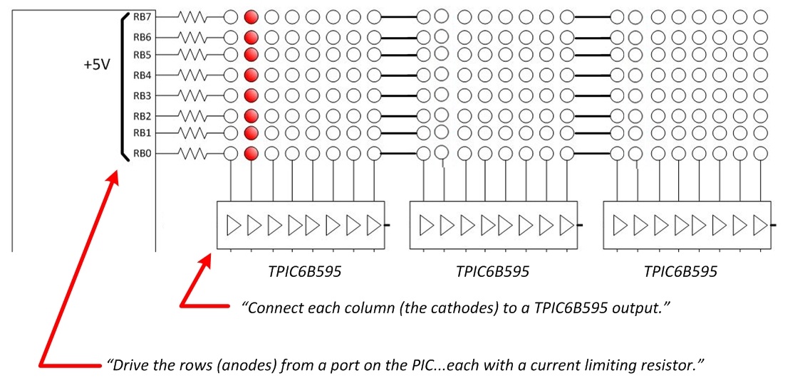

You said you bought common cathode matrices. You have everything you need as I have explained several times.
Drive the rows (anodes) from a port on the PIC...each with a current limiting resistor.
Connect each column (the cathodes) to a TPIC6B595 output.
Rotate a "1" across the line of TPIC6B595s.
Questions? See my previous posts.

Now that sounds easier than using the 74hc595's BUT I need 32 ports just for the anodes if I am interpreting right?
using a 18F4520 so I should have a few extra ports. Need to calculate.

If I connect as per post 18 then 32 port pins for the anodes and 3 for the shift register then using a 18f4520 (dip-40 pkg) you run out of pins.
36 for anodes, 2 for Vdd and 2 for Vss. Data sheet says 35 I/O pins.
That is following post 18

If you've mounted and wired your displays in a configuration of 8 common cathode rows and 32 common anode columns, Raj Bhatt's 74HC595 circuit on Embedded-Lab should work fine. I would make sure to drive the display one row at a time for a 1/8th (12.5%) duty cycle.
You could also replace the 8-bit serial-to-parallel sinking driver ICs with 8-bit serial-to-parallel source driver ICs. I only know of one, the **broken link removed**.
As an alternative, turn each display 90° on your board and wire them up as 8 common anode rows and 32 common cathode columns. Then you can keep the 8-bit serial-to-parallel TPIC6B595 sinking drivers for the columns but you'll need 8 PNP transistors or 8 P-Channel MOSFETs to "source" the anode rows. Again, I would recommend driving the display one row at a time for a 1/8th (12.5%) duty cycle instead of driving one column at a time (1/32nd duty cycle).

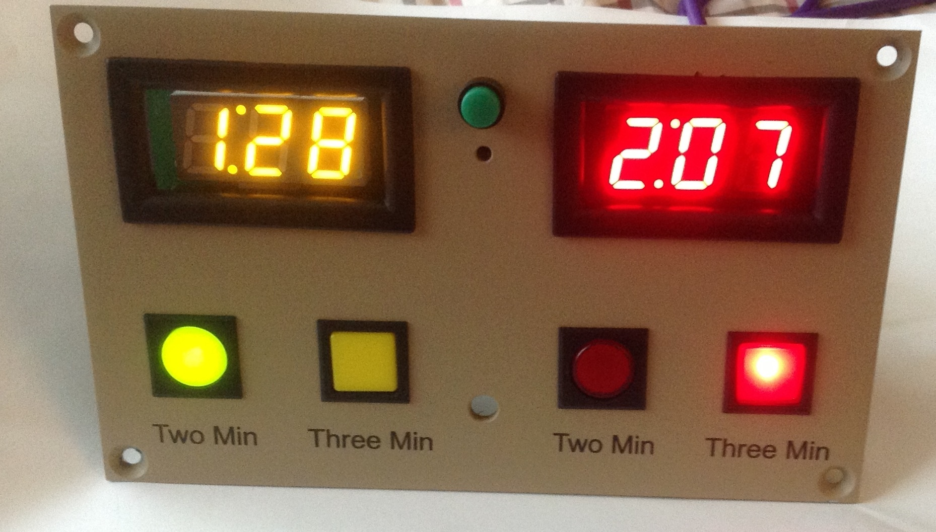

Here's a project I did for the FAA using a MAX7219.

Thanks. While waiting for the 74hc595's from Jameco I am rewiring my board one pin at a time.
I now understand what Jon was referring to about driving the anodes off of port pins and cathodes to the shift registers. A picture is worth a 1000 words.
