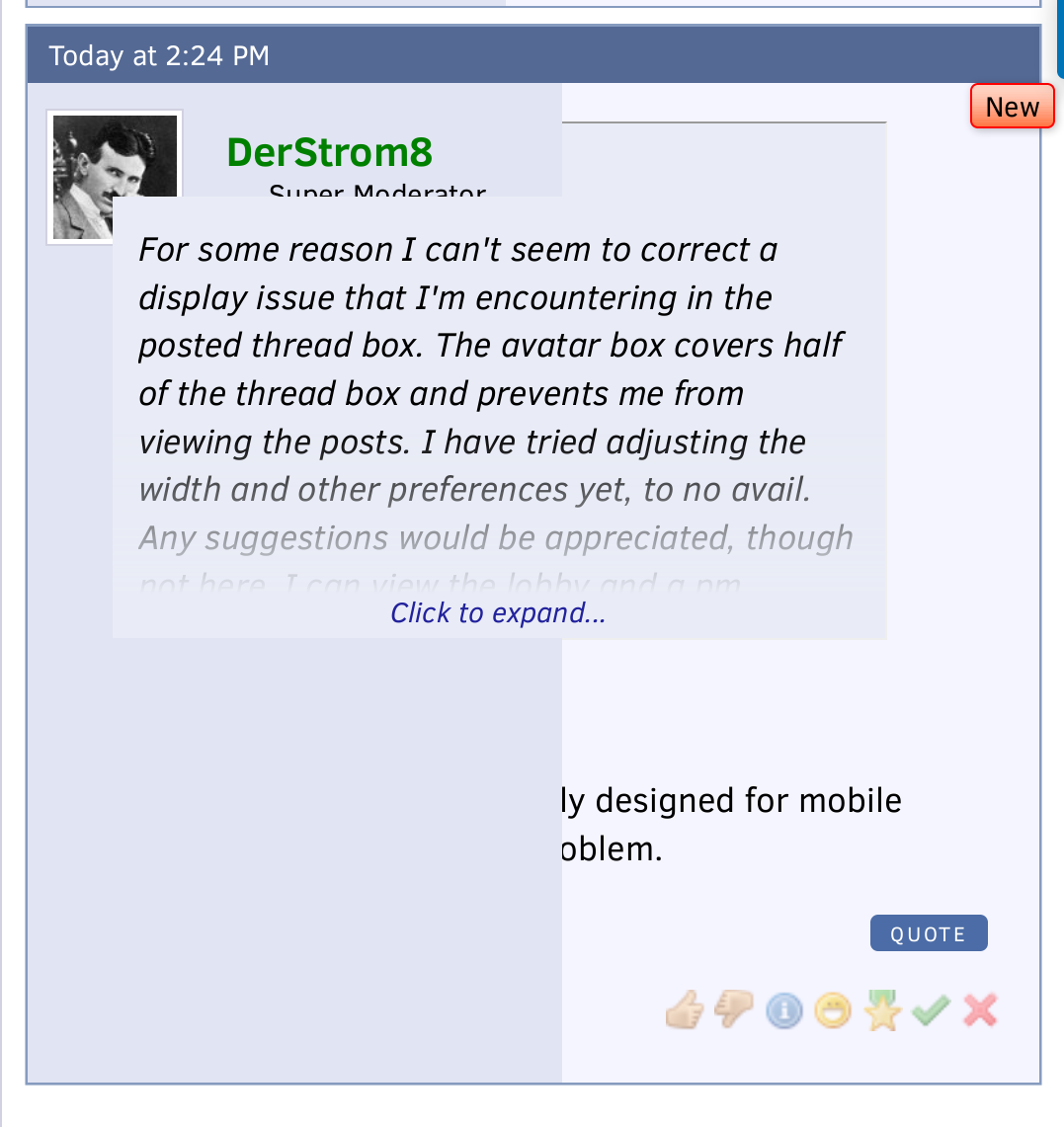

For some reason I can't seem to correct a display issue that I'm encountering in the posted thread box. The avatar box covers half of the thread box and prevents me from viewing the posts. I have tried adjusting the width and other preferences yet, to no avail. Any suggestions would be appreciated, though not here. I can view the lobby and a pm.
Could you post a screenshot?
Last I knew this site wasn't really designed for mobile viewing, so that could be the problem.
It used to work fine uo until a few months ago. In portrait mode, it's useless. I rotate my phone to get around it. Prior to a few months ago, this was not a problem.
I believe there was recently a software update, so with that it probably wiped away all the settings to make it readable on mobile devices (assuming that's what you're using). Unfortunately there isn't an immediate fix that I am aware of, unless the administrators update the software with a mobile-friendly version.
