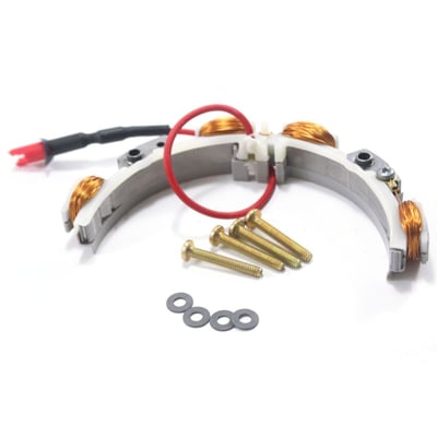

Garden tractors often use a single diode on the alternator output to obtain DC. Am I correct in thinking that one could replace the diode with a bridge rectifier and get a few more amps out.
It could be that doing so might overheat the alternator coils but then large draws are normally associated with things turning on so maybe it would work to provide more peak current. They are constructed like the one below. Higher output units use a full circle of coils.
PD_0071_500_696578

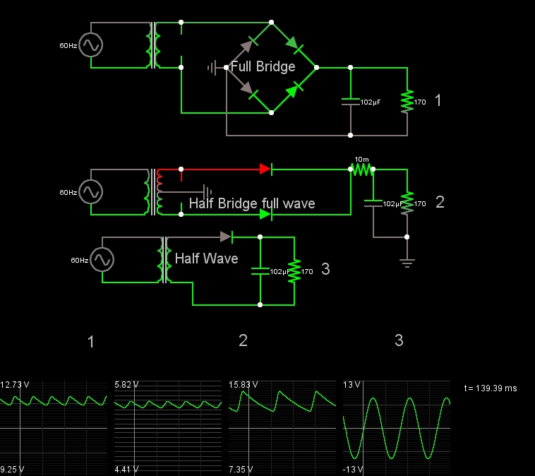

BZZZZZTTTT! You are mixing transformers with rectifiers. A given winding fed to a single diode makes a peak output ~1.4*Vrms of the winding. Same winding fed to a full-wave four diode bridge makes a slightly lower peak voltage due to the forward drop of the extra diode in the forward path...
If filtering it with a capacitor, the full-wave output is easier to filter because the current pulses come at twice the rate. The full wave rectifier will draw more power from a given winding that half-wave...
Bzzzzt half bridge has less ripple , less voltage ( but twice current at same ripple) . Full bridge has more. Half Wave has excess ripple at rated load.
Note the minimum voltage in each 1,2,3

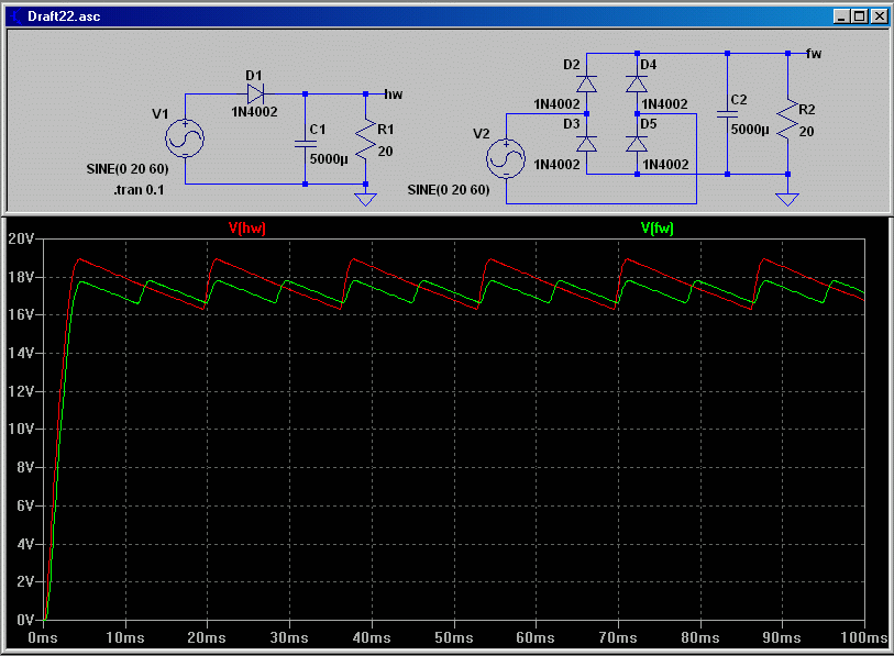

I did that with configurations 1 & 3 . Look again pls. The fourth is the input sine wave using 1:1 transformers
Note that the ripple Vp-p and minimum voltage is worse with a single diode.
Different scales but see peak +- V on each waveform is indicated.
