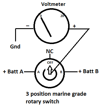

    Thanks for all that. Got a new one for you.
    I am fitting a Blue Sea charging system to the two batteries in the boat. I would like a voltmeter for each battery to show condition of each. Will this work?
  10. cowboybob
    cowboybob Well-Known Member Most Helpful Member
    Joined:
    Oct 22, 2011
    Messages:
    3,050
    Likes:
    478
    Location:
    James Island, SC
    ONLINE
    TK,
    How will the batteries be wired (and used), i.e., separately (using 2 chargers) or in parallel (1 charger)?
    How you monitor their voltage level depends on the above. But keep in mind that a lead acid battery's voltage level does not indicate its capacity (energy density). This is best checked with either a hydrometer or a resistive load tester. Neither of these are used as a continuous indicator - they are only for periodic testing.
  11. Tony K
    Tony K Member
    Joined:
    Dec 20, 2016
    Messages:
    42
    Likes:
    0
    [​IMG]
    This is the wiring diagram for the Blue Sea set up found at
    https://www.bluesea.com/products/7650/Add-A-Battery_Kit_-_120A
    I do not have an outboard, but a 27hp diesel inboard with one 55 amp alternator. I got two volt meters because there are two batteries but where do I wire in the voltmeters to monitor battery condition simultaneously? Because, if the Blue Sea charging relay shuts off charging to one battery presumably I won't get a reading on one of the voltmeters? I a right about this or just dumb? Don't answer that last bit!

    You can (if you so choose) put a separate voltmeter (VM) directly across each respective battery. From the ACR data above, though, they will not give you individual battery readings during charging (any time the engine is on), engine cranking OR when you use the Dual Circuit Plus™ Battery Switch set to the emergency starting position.
    Thus, VMs will only indicate true, unloaded battery voltage when the engine if OFF. And, as I said, this is not a valid battery condition indicator.

    If you have the system as shown in Post #10, the two batteries serve 2 loads: 1. the starter (and engine which includes the alternator) and, 2. the boats electronics. They can be combined (in parallel) for emergency purposes.
    As I understand the description of the operation of the Bluesea rig you posted, it appears the two batteries are charged simultaneously which, would, of course, puts the same voltage level on both batteries during the charging process. So, yes, separate VMs would be redundant.
    However, the ACR does, apparently, isolate the 2 from each other when OFF or if one or the other needs no charge. So, in that case, 2 VMs would be indicating separate voltage levels (i.e., Charging level or normal battery level values).
    However, given that I have no idea how the system might, eventually, be wired (there are other options), I'd suggest the following:
    One VM and a 3 position switch wired as below:
    Just check the batteries as you see fit, always returning the switch to "OFF".

    Thanks for that and thanks for the idea with a switch. It's clearer now for me.
