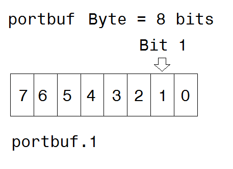

    What I don't understand in this code is you write "portbuf.1" what is that ".1" exactly doing?
    I use this solution earlier but without that ".1" now I am wondering what does that?
    Please explain this.

    Accessing bits within a byte,, The dot operator can achieve this...
    portbuf.1 accesses bit 1 within the byte..

    I suppose that I can also use bit 2 or 3? With the same result.

    Yes...
    The dot operator can also be used with word sized variables to access hi byte and low byte.
