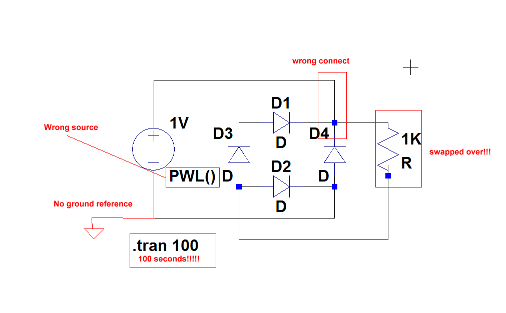

Hello, I am learning about diodes and I'm a bit confused about how they work, etc. I tried to replicate this on LTSPICE and ran into problems. Any help is appreciated! :)
  • DIODE.asc

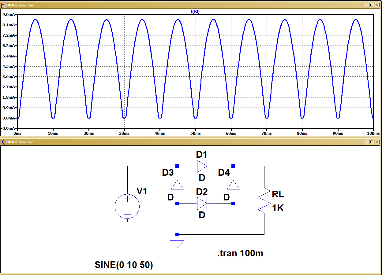

Try this sim, yours was incorrect.
