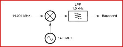

I need to down convert a frequency of around 88 - 108MHz to about 40kHz.
I thought about using an AD831 mixer,but at an IF frequency of 10MHz I'll only go down a few MHz not to 40khz so I will need multiple mixers,and the AD831 is very expensive,what other mixers can i use that are less expensive?
Or are there mixers that perform dual operations?
That range? All frequencies between 88 to 108 MHz to a single frequency of 40kHz?
I'm curious. What for?
<EDIT> Right off the top of my head, just modulate the range 88 to 108MHZ of a sig gen's output with a constant 40kHz and demodulate that signal.
the 88 - 108 is generally just FM spectrum,I need to convert it to about 40-50kHz for digital signal processing purposes.
Will I need more than 2 mixers in this case?
Just off the top of my head, have you considered feeding the AD832, for example, a 98MHz unmodulated carrier, mixing it with a 98.040MHz signal and running the resultant signal through a very tight 40kHz band pass filter (BPF)?
(An example only)
The BPF might conceivably introduce unacceptable noise.
You would need a tuneable source of 88MHz to 108MHz to mix with the signal to get the 40kHz output (signal source being 40kHz above or below the signal being tuned) and a high-order 40kHz bandpass filter after the mixer. But note that the bandwidth of a standard FM signal is much greater than 40kHz (about 150kHz) so you cannot make an FM radio that way, if that is your intention.

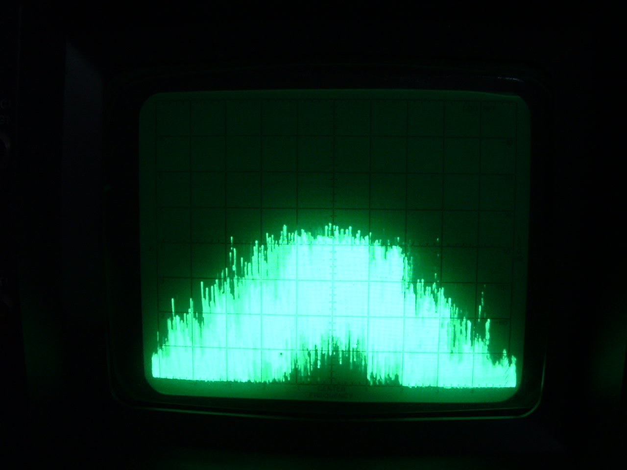

To try and clarify your thinking, have a look at the attached picture taken from the screen of a spectrum analyser which was looking at an off air FM radio signal.
The analyser was set to 3KHz Resolution Bandwidth and the horizontal sweep is set to 20KHz per division.
The vertical scale is 10dB per division.
The picture is a composite of several sweeps across the screen of the analogue storage scope display.
You will see that the signal occupies far more than 40KHz.
