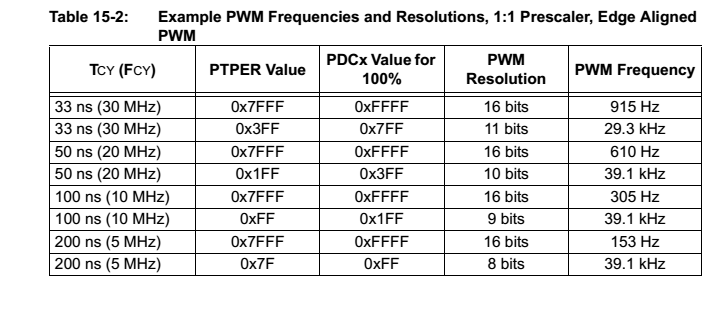

    But every time will it be 8 bit or 10 bit? Because as per the data sheet information the resolution is changing, even though the pdc register is 16 bit for duty cycle. It keeps varying based on the pwm frequency I think. Can you please help me understand. I am not sure if i am following or i am deviating from the actual question. Does fractional duty cycle in percentages and the resolution have any relation?

    If you look at the PDCx value, you will notice that the number of bits set is the same as the resolution. I.E. 0x3fff = 11 1111 1111 = 10 bits set. This is the value that the counter resets at and so the max PWM value is the same as this max value. However, because the counter is being clocked at a certain frequency then the frequency drops as the value of PDC increases. E.G. at 10MHz and PDC value of 0x1ff (512 steps) the frequency is 10,000,000/512 = 19.5kHz - at 20MHz = 39.1 etc.

    so the faster the PWM frequency the fewer possible steps in your duty cycle.
    In your application you need to select a duty cycle depending on what your doing. So for an LED dimmer 915Hz will be more than fine and this gives you 16bit duty cycle register.
