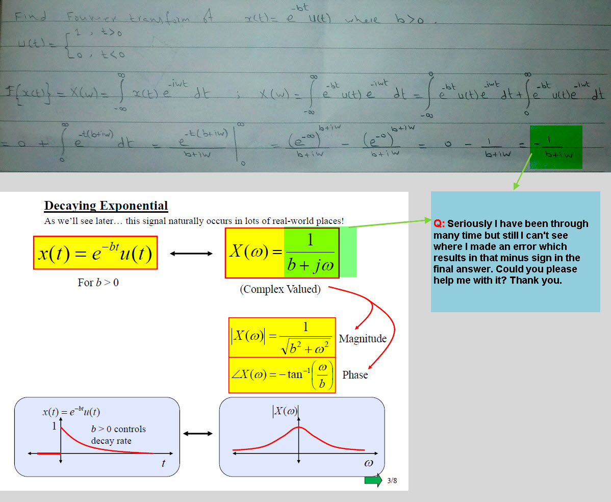

Q1:
Anyway, I have been through the problem from this post which prompted all this discussion that day. Please have a look here.
Q2:
Could you please help me with this query? Thanks very much.

For Q2, the sign error occurs when you take the anti-derivative of the exponential. You need a negative sign at that point.
