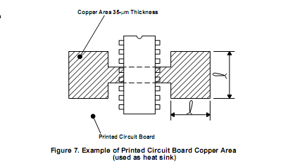

I tried the ckt with 1A adapter and both motor runs very fast , the ckt was still hanging so I pu 47 ohm resistors in series of each motors and WOW :)! the robot runs fine but either 1A or 500mA both makes 7805 and L293D slightly hot, I probably can touch 7805 heat sink but only for 10 or so seconds after that I really feel the heat ( this is for 500mA so imagine for 1A :eek:) while L293D doesn't get that much hot but still it seems to me that I have a disaster in waiting, or is this normal ? Will a heat sink do ? What with L293D ? I can't attach a heat sink to that.
Hi There,
Fit a good sized heatsink to the 7805 and refer to this image for the L293.
Thanks ! Eric for the idea, now my next post will take some time and hope that will be the final one as I have to fix ckt and motor and all that stuff in to a ROBOT form so see you then :),

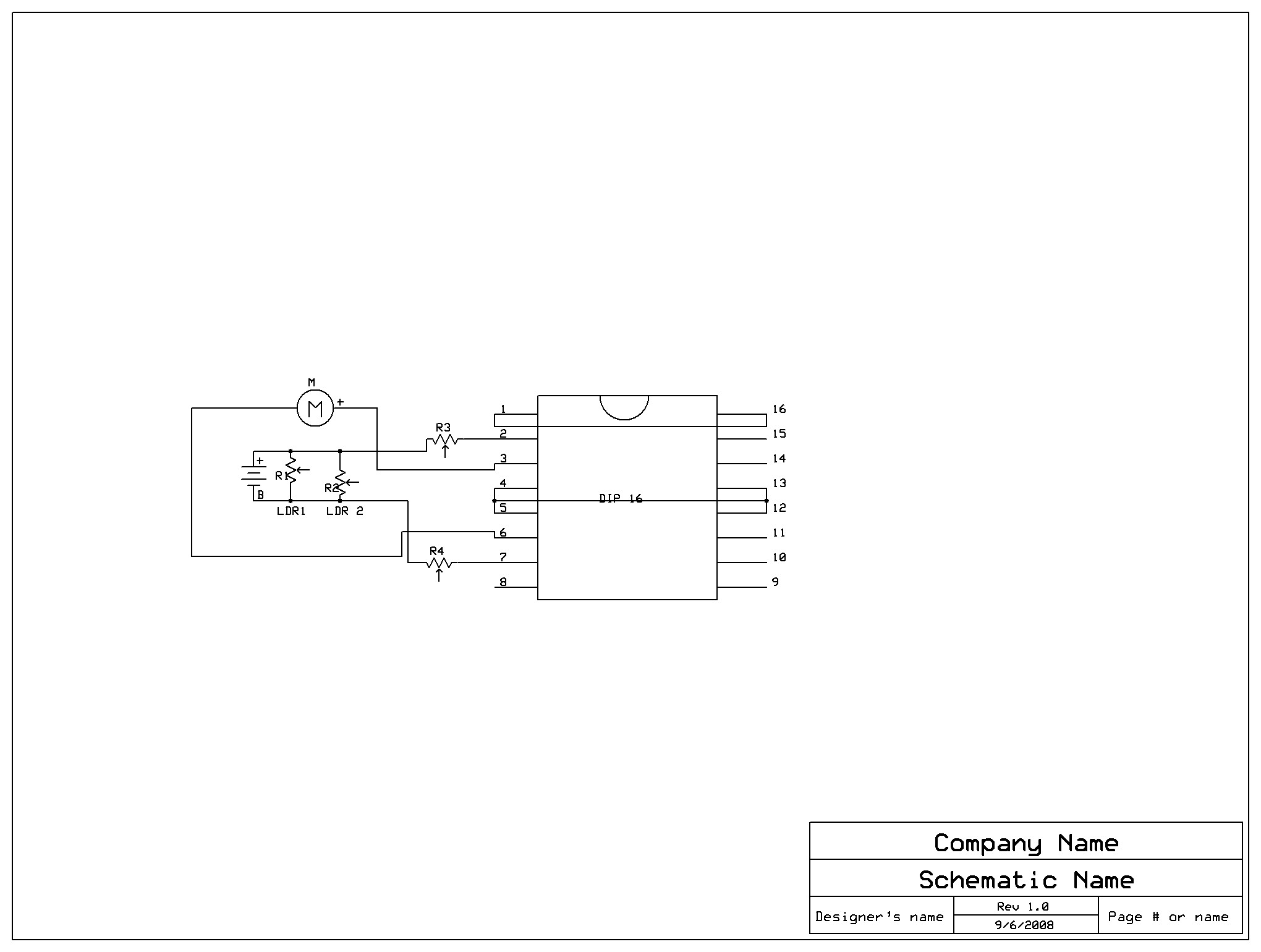

Hi there,
It's working very nice and quite speedy, just some times ambient light disturbs it but, drawing curtains solved that. I need to clear some points that I think I understood .
1 : The large capacitor across +5v and GND of 7805 makes it work as a current source as voltage can not change instantaneously across a capacitor and thus offering a huge parallel resistance.
Quastion :
If my understanding is right than why it needs to be large capacitance ? , I mean the resistance offered by capacitor is inversely proportional to the capacitance so 1 pico will offer more resistance than 1000u .
2: Can this ckt works if I don't want to use MCU ? In attachement I have just shown the ckt for single motor. The IC is L293D and consider it as properly supplied.
