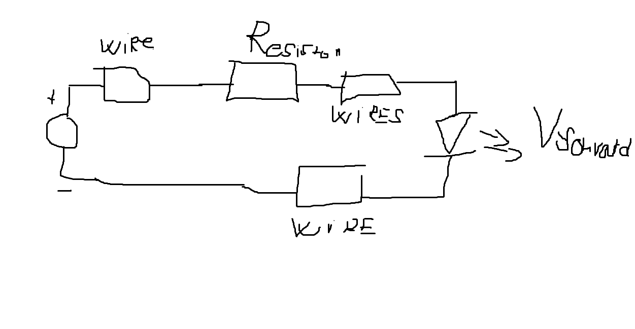

If you connect it directly to power supply it will blow.
You need calacute resistor.
(VCC-Vforward-Rwires*Idiode)/Idiode)
No one care about wires Rwires. Rwires aprox 0 ohms
Profesional picture attached:
Also i remember your post, when you said you have good understanding in electronics parts.
Profesional picture attached:View attachment 129811

Ok sorry my first comment coul be dissaponting. All diodes has forvard voltage proportional to passing current. Higher current means higher forward voltage. You need to take a look to datasheet. For emiting diodes i never do this. I just select forward voltage in range of 2-3V and current aprox 5mA. If you want exactly 5mA than you would need something like current mirror as current source. Also forward voltage on leds vary by colours

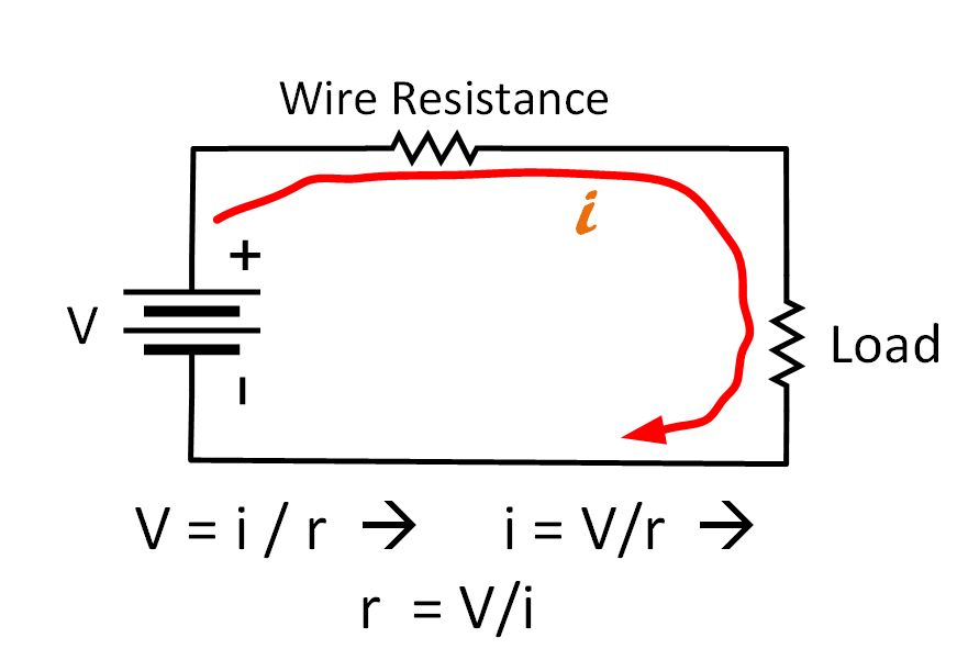

Let's drop back to Ohm's Law: V = i/r, which can be rearranged as i = V/r or r = V/i, where V is volts, i is current in amps and r = Ohms.
In the circuit below, we have a battery, (which we will assume has a constant voltage regardless of load and no internal resistance), a resistor representing the circuit load and another resistor representing the resistance of the wiring and connections. The current, shown by the red line, is constant throughout the circuit, since everything is in series.
Let's say the battery provides 12 volts, the load has a resistance of 10 Ohms, and assume the wiring has 0 ohms resistance,
Use Ohm's law to find the current:
i = V/r = 12/10 = 1.2 amps.
If the cable resistance truly is zero Ohms, the voltage across the Load will be the same as the (ideal) battery voltage.
But let's say the voltage across the load only measures 11 volts. That means 1 volt is being dropped across the cable resistance, which is actually spread out rather than being a single lump like I've shown here. Back to Ohm's law. We can calculate the resistance in the cable.
We already know 1 volt is dropped across the cable resistance. But what's the current? The load is 10 Ohms we know, and there's 11 volts across it.
i = V/r = 11/10 = 1.1 amps.
The same current is flowing through the cable, so we know the voltage drop caused by the cable resistance, and the current, so
r = V/i = 1/1.1 = 0.91 Ohms = cable resistance.
Let's doublecheck our calulations.
Rload = 10 Ohms
Rcable = 0.91 Ohms
Rtotal = Rload + Rcable = 10 + 0.91 = 10.91 Ohms
i = V/r = 12/10.91 = 1.1 amps.

If you have only a power supply and a load, the voltage across the load will equal the power supply voltage. But if we dig a little deeper, the cable has resistance (as I showed above) and a power supply will have internal resistance. This internal resistance is usually very small and usually insignificant. The lower this internal resistance, the more "stiff" a power supply is called,
Rload = 10 Ohms
Rcable = 0.91 Ohms
You explained that very well. Thank you. I guess I thought voltage was way more effected by resistance than it really is. So I know your banging your heads against the table right now, but just help me clarify this... If I had say, 100 volts as the source going through wire (imagining no voltage drop) going across a 500 ohm resistor like the previous picture but this time there is a load adding which is a lamp or something that draws a little more current, would the voltage read STILL remain 100 volts? Even when resistance is increased and increased? My understanding of Kirchhoff's law is the voltage drops add to equal the input voltage. Is current and voltage not effected by the other??? Please give me a new perspective of my flawed view of this. Or maybe point me where I can learn.
Thank you, Ben
If the lamp is added in parallel to the load resistor, the voltage across both would be the same. But the combined resistance would be lower (look up adding resistors in parallel), so the current would be higher from the power supply.
If the lamp was in series with the load resistor, the effective resistance is the sum of the two resistances, and the current through the circuit would drop accordingly.

OOOOOOOOHHHHH. I just had a light bulb moment!!! there is always two resistors!!!
In series with the lamp the lamp might be 2 ohms and in series with the 500 ohm resistor I can then use the simple ohms law equation to find the voltage drop after each resistor!!
