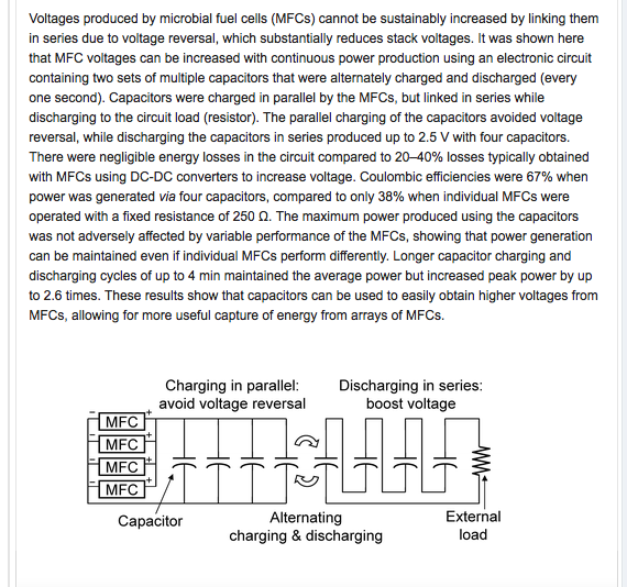

I'm wondering if transistors can be used to automatically switch back and forth between 2 banks of capacitors? The low voltage power source (microbial fuel cell) needs to charge one bank while the other is discharging, without risk of polarity reversal (which the capacitors may protect against?). Does anyone here know where I can find this info? I'll be using a breadboard and some basic components to experiment with this idea but I'm not sure where to start. I have a bank of MFCs producing between 1.8 and 2.2 volts.

Here's what I want to add but I haven't figured out how to do it yet.

A "charge pump" is very close to what you are trying to do.
It appears you want to have two banks, one charging and one discharging.
I think CowBoyBob is right. Use a PWM boost circuit (low voltage to high voltage) and only have one bank.
See attached data sheet. 0.9 to 1.8V to 3.3V charge pump If this is close then there are many different kinds of these. This type of charge pump would work with only one set of capacitors.
