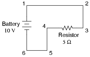

Electrically common points on a circuit (equals no voltage)
Just reading and confused about this anyone get it?
not sure really about how it works ( is just a measured phenomenon where there is no explanation just something to remember is true?)
[or is there a fact about the workings of voltage that states this rationally]
ok this is the principal that i am confused with
It says that in an ideal circuit where wire and power resistance is neglected points which are electrically common should be measured to have zero voltage and have very little voltage drop between them.
( points that are not electrically common will be measured as the voltage of the battery so 6-1 will be 10 volts and 4-3 will be 10 volts(neglecting component resistance)( so will 4-2 ,4-1,6-2... will also get 10 volts when measured between the two points)
Between points 1 and 2 = 0 volts Points 1, 2, and 3 are (they can be considered as a single wire)
Between points 2 and 3 = 0 volts electrically common
Between points 1 and 3 = 0 volts
Between points 4 and 5 = 0 volts Points 4, 5, and 6 are
Between points 5 and 6 = 0 volts electrically common
Between points 4 and 6 = 0 volts

How would you explain "electrically common" to someone?
'Electrically common' means the points have the same electric 'potential'. Thus there is zero 'potential difference' between them. Voltage = potential difference.
A bird on a power line has the same electric potential as the line (say 20kV), so there is no potential difference between it and the line, so no current can flow to harm it. If the bird were able to sit on the line and reach out a wing to touch the pylon (which is at ground potential), then ZAP!

there is something i still don't get. i will try to explain
What I Think Is that Electrically Common Points When Measured Across Have Zero Voltage
ok say for example P1 and P2 are electrically common you say that they have the same ELECTRIC POTENTIAL so at both points P1=10vs P2=1ovolts
And then you say that in conclusion that means There is zero "potential difference/voltage" between them so that means when points p1 and p2 are measured on multimeter there should be zero voltage( alright think i am kind of getting it down in theory, just have to remember no voltage across electrically common points right?)
So for the bird it has electric potential(just like becoming one with the wire) but no voltage through it to drive current to the body because it is not connected to the neutral wire and back to the source like the hot wire that the bird is touching is and thus bird not get zapped?[ ok i get the bird thing, it is because bird is not connecting both wires of the circuit ]
Oh this is so confusing....... soo.... isn't electric potential the amount of charge a charge carrier has?
onetwothree4, it seems that what you are understanding is basically correct. There is NO potential difference(assume perfect conductors) between points 1 and 3 and NO potential difference between point 4 and 6. Remove points 2 and 5. They are irrelevant and just confuse the issue.
There is a 10v potential difference between points 3 and 4 since that is where the battery is connected.
If you measure between ANY point along the wire 4 and 6 to any other point along the wire 1 and 3 there will be 10v potential difference.
This 10v potential difference will cause a current to flow in the resistor equal to Volts/Resistance and since you have no switch in this CIRCUIT this will flatten the battery in some time. If you had a switch and switched it off the the 10v potential difference could be measured across the open switch and you would have an OPEN Circuit and NO current would flow.
The potential at P1 and P2 is 10V with respect to P5 and P6. Remember that a voltage is always between two points (if there is a ground or common point designated in the circuit then it would be with reference to that but that's not the case with this diagram).
