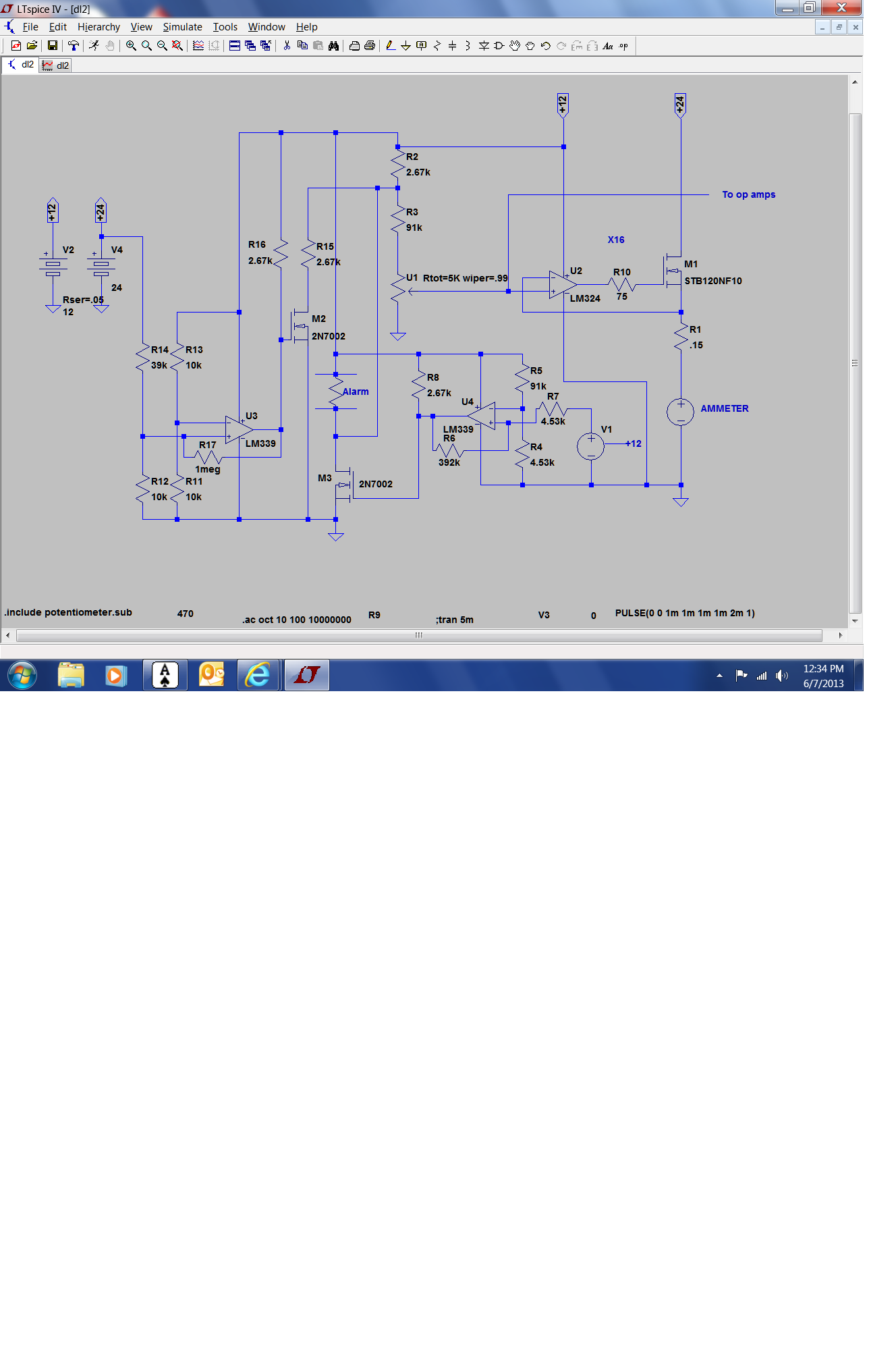

As far as priorities, the way I see it, there really wasn't anything wrong with the original design. I think it would still be functioning and serving the purposes I needed it for today had I not shorted the op-amp and ruined it by my own human error. Now that being said, I thought if I have to build it again, I might as well see if we could improve it by making it not oscillate as much and improve the amount of power it could handle. In actuality, if that turns out to be more trouble than it's worth, I would just as soon simply rebuild the original design ;)... don't get me wrong, I am appreciative of all the input and hopefully the end result is we get a better more robust dummy load out of it.

I think I may just keep it simple and go with the original design, since it worked...but just add 15 mosfets instead of 10. Also, I will put a watt meter in there to get current readings...this one:

Do you still have a schematic for dummy load one? I have changed computers since then.........
If you stay with DLI we might want to at least change the op amp and make the resistors higher power to cool them down a bit. Whatca think?
Did you find a source for more supplies?.
Thanks Ron. The move went well. I did find a good source for more power supplies. I agree, let's at least change the current sense resistors to not get so hot and the op-amps. The final schematic for dummy load I is attached to post 1. I don't remember if I have the actual LTsplice file. It seems like you may have sent it to me at some point. Let me know if you want me to search around for it or if the PDF on post 1 of this thread will be enough.

When I make simple linear dummy loads, they are either current controlled (with the pot biasing the emitter resistors in reference to a fixed 5v) or are roughly "resistive" (so the pot biases the emitter resistors in reference to the input voltage).
The good thing about those types of operation is that the main voltage voltage can be anything, the only thing that happens with a higher Vin is that it will make more dissipation (for the same pot position).
To allow the system to transition from 24v -> 48v safely and "automagically" would simply require that you have a comparator/op-amp that senses the input line and de-bias the current control pot by half whenever Vin passed a certain threshold. Such an implementation is fairly straightforward.
Something that I was saying about this before though is that it should be just as equally straightforward to solve this problem with a fully linear solution and almost the same circuit if we wanted to. We simply need to find the correct offset coefficient and apply that to the current pot via an inverting op amp circuit. Should be as easy as pie.
The benefits of doing this are debatable however. All it would mean is the circuit could take mostly arbitrary voltages between 0 and 48 volts and would never allow you to set itself to draw more than the wattage that it could safely dissipate. Of course, even with this setup, one could always apply more voltage than some critical part can handle and the system would then still break down.
The final solution is to "simply" make the system able to safely handle 48v * 50A = ~2,500 watts. Which means... it would need to be quite beastly.

How about this? You could test each supply until the over current trips. 55 amps? then build them into 48 volt supplies and test them at 30 amps. This would have the added benefit that they might run on a 120 volt outlet. We could auto adjust for the lower current, as ()blivion suggested at say 28 volts.

Do note that, all shunt based amp meters have an internal resistance needed to develop across it a measurable voltage relative to the current. So... having the amp meter between the ground and the sense resistor could potentially de-calibrate the actual current from the intended current setting. With this in mind, it would be best to put the meter above the MOSFET rather than below, if at all humanly possible.
That being said, that resistance is itself an amp measuring device. So regardless of where it is, we should still be able to know the correct amps.
Thanks ronv and duly noted ()blivion. So could I run 48v through that circuit? Of course being careful not to exceed the rated wattage.
Yes the MOSFET's are the part that would fail if anything, and they look to be able to handle 100v/2. With 16 of them at 150 watts each (playing it safe-ish), 2400 watts should be the upper limit for power.
I don't think the proposed circuit has any kind of auto current limit feature as of yet though. Ronv may get back to us on that yet still. So may not want to heat up the soldering iron just yet.
