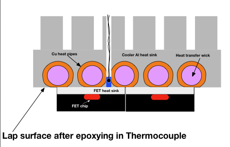

I was wondering how you drilled/tapped a heat pipe sink. They usually don't leave any room for that sort of thing.:)
jj, from your description it sounds like we might get by with three FDL100s @ 500W each if the water cooler has sufficiently low thermal resistance (and from observed data it appears to be around 0.025) and with four FDL100s @ 375W each we should be in pretty comfortable territory. Is that correct?
Very carefully. :)
There was just enough clearance between the Cu pipes on my particular cooler to get a 2mm drill through and the thermocouple bead just made it.
The Cu tubes were reasonably thick walled and I could see there was probably a bit of slack from the flats ground on the base. In the end no Cu came out of the drill hole so i think I got it exactly down the middle of the gap.

That's what I'm thinking but I am still testing this rig and, as usual, not everything is plain sailing. I have popped a couple of FETs and we don't know whether they were killed by stupidity (likely) or are in fact under-spec parts (entirely possible as these did not come from a traceable supplier).
Also yesterday after a few tidy ups on the control board the same FETs that did over 700 Watts were looking like they were uncomfortable at 600. There is a way to go as I need to properly isolate my three loads and test them separately. We may have some FET weirdness going on in the unpowered loads.
In short I think yes, but I'm not 100% sure at this time. I would hate for people to burn out these expensive FETs without checking carefully for themselves.
The advantage of the water cooled solution is that if you get it sorted for one FET I think you can just add more and keep the same rating because the heat sink itself is so effective.
