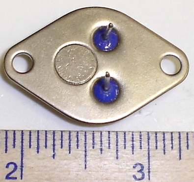

I just grabbed my pro transistor substitution book, with literally tens of thousands of transistors listed from many decades. Scanning through lots of pages for that package (TO-264) shows it's a 100W package, ie all the highest TO-264 devices are rated at 100W max.
A TO-220 is about a 60W package, a TO-264 (or TOP-3) is about 100W and the massive old TO-3 is about 200W-250W at best.
I'm beginning to think the cheaper manufacturers are starting to rate their parts in "whats?" instead of "watts" and it's going the way of the audio amplifier industry.
You can't expect to get 2500W out of a package that has had decades of use from many manufacturers at a known max safe dissipation of 100W. :(
(edit) I just googled for a REAL high power semi, this Hitachi IGBT (top middle in photo);
Is 130mm * 140m in size, and is rated for 1200 amps DC at around a typical 2v Vce (ie rated at a 2400W continuous dissipation).

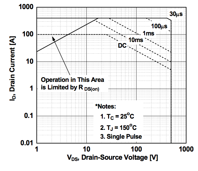

The huge electrical power ratings of these things are meaningless since that is for switching applications. In linear application it is a thermal, not electrical, problem. You still have to watch the DC SOA but it is getting the heat away that is the limiting factor.

I have to agree with Mr RB, 2500 watts isn't going to happen. That rating is almost certainly what it is calculated to switch, and even that is a dubious claim. At some current, even if the die can take it, the leads will melt. It would have to get most of it's watts from voltage to be able to switch that.
For dissipating power, you have to remember that the actual part making all the heat is a square of what basically a gram or two of glass the size of your pinky nail. Well, the several feet and several grams of Ni-Cr resistance wire in my space heater gets red hot at 1300 watt. Trying to get that much heat to come out of that tiny piece of glass would require it to be several times over it's melting temp, let alone above it's max junction temp. Simply not happening.
Even with amazing heat-sinking, the material the chip is made out of will have enough thermal resistance to hold the heat in and destroy the thing.

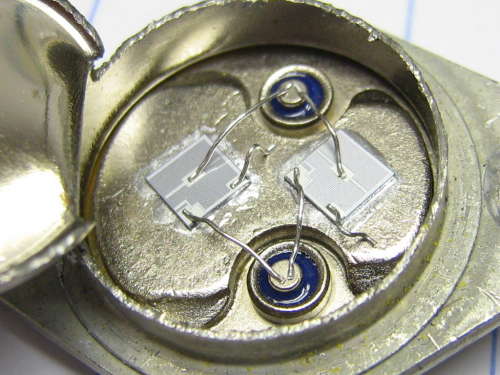

Here is what the inside of a (larger) power transistor looks like...
And here is the size of the full case...
It's just as jj604 said, virtually every power transistor that we have looked at was intended to be used as a power switch. And the datasheet power rating is very often a reflection that application, sans marketing.

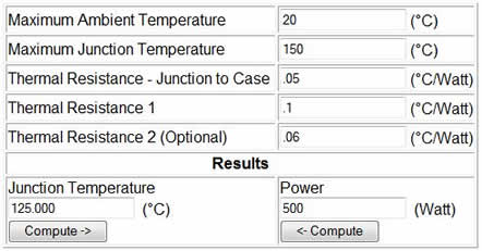

Don't forget if you have more than one FET that the heat paths are in parallel for the FETs but are then in series with that for the single heat sink.
There's a heat sink calculator here: https://www.daycounter.com/Calculators/Heat-Sink-Temperature-Calculator.phtml where you can play around with the values and see what affect they have.
Here's an example (see attachment) where Thermal Resistance 1 is the stated case to sink resistance and Thermal Resistance 2 is the sink resistance.
If you believe the data sheet (and I do) we have 2 unknowns in this application:
1- Thermal resistance case to heat-sink. This could be very low in this case since the FETs are soldered to the water pipe. - IC engineer turns over in his grave. :rolleyes:
2- Thermal resistance of the heat-sink - estimated at .025C/Watt or better based on ()blivion and Jeremy data.
