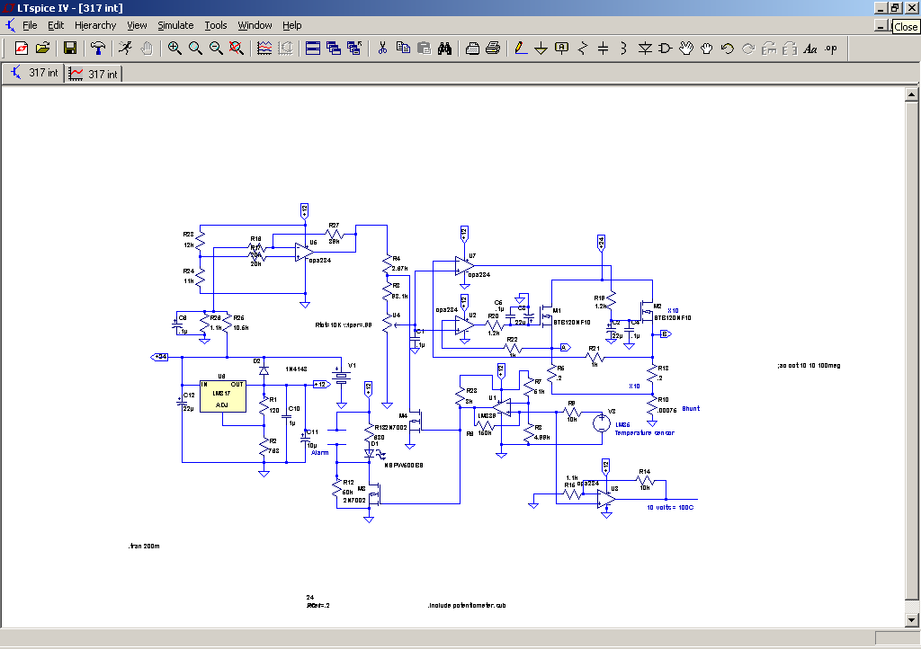

So Jeremy, I think we are where you need to decide on the auto current adjust and we are almost ready to finalize it. The auto adjust is not much more than the old current read out circuit.

I think we are ok. The problem with power up was the 12 volts had been on but no 24, so the fet was turned on fully because there was no current. When the 24 came on the long time constant of the integrator kept the current very high for quite some time. Now the 12 comes on after the 24 so that problem is gone.
I have played with power down, but not since we said we would go up to 50 volts. There might be a problem there. :(
When it was just the 24 the maximum current was limited to 4 amps by the pot running off of +12. I have a diode from +12 to +24 to keep current from going backwards thru the regulator so the 12 volts follows the 24 down. It did look like there were some timings (power on/off glitches) that would get the current a little higher than the set point but not higher than 4 amps/FET.

Might as well go first class. We will take a look at the auto range.
Dl2.1
Wasn't quite as easy as I thought it might be. :rolleyes:
Here is a first pass with auto range.
Here is what I did. I let the op amp go to the positive rail at about 24 volts so that is the highest current. It's not a well speced place but might be ok. What'ca think?
Couldn't do the alarm the same way with the variable reference voltage so I flipped the comparator and added a couple of little FETs to turn the current off with high temperature and turn on the alarm. I haven't tried to test all the power up/down and ripple stuff, so if you have some time give it a go.

How do you do the potentiometer thing again? That is the only thing stopping me from being able to play with the *.asc file. "Model not defined" or some such thing...
