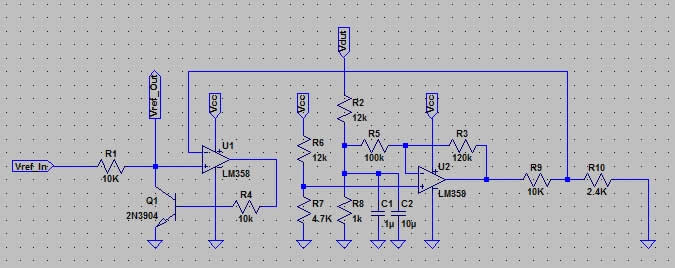

I was thinking something like the attached file that simply limits Vref based on the Vdut. The higher Vdut goes the lower the clamp on Vref goes. It's not dialed in but you get the idea.
If you use the Vout of the DUT as Vref, it will scale the closed loop current proportional to the DUT voltage, so the entire dummy load acts like a big resistor.
That may have some value as an "open loop" mode, re previous conversation.

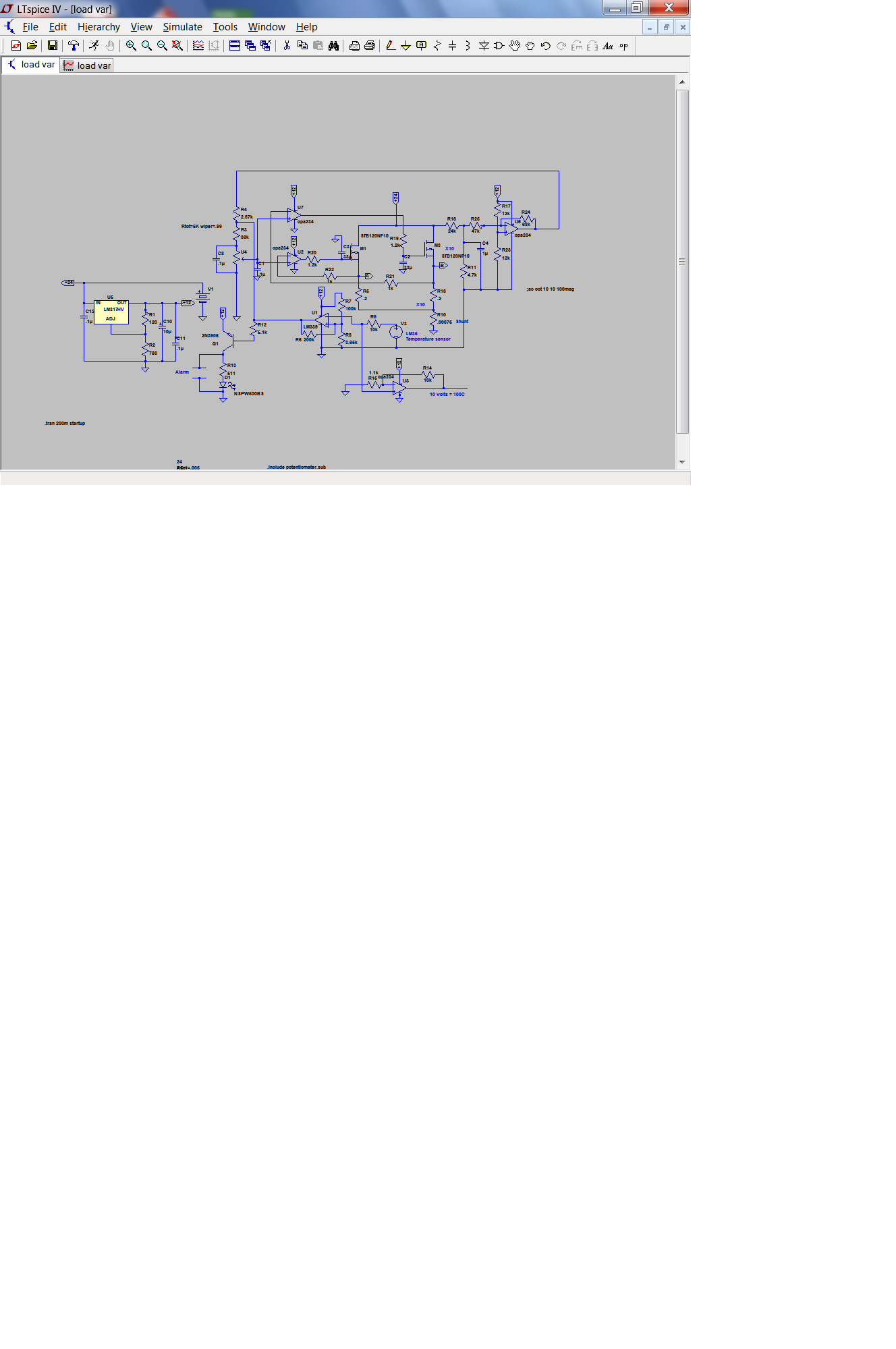

This is the one I was looking at.

Actually, the FET is just inside its safe operating area at 4 amps at 50 volts so the temperature sensor would probably protect it if the current was turned up, but it is not that much more stuff. I could go either way. Up to you guys.
I kind of like having the option to flip it on and leave the current below 10 amps for a second or two to see if a PSU is working without turning on the water.
OK. So I guess it boils down to whether or not you want to have the added complexity of automatically turning down the current as the voltage goes up or if you want the 30 amp setting to be 30 amps no matter what the supply (DUT) voltage is. I'm not sure how it would act if you have a bad supply that say only put out 5 volts instead of 12, I guess it would increase the current above where it would be with the normal setting. Have you had any bad ones? How did they fail?
Correct me if I am wrong, but I think if we did it that way it would scale a higher voltage to be a higher current... wouldn't it? High reference voltage = high current.
I was just thinking we would use an Op-Amp based inverting amplifier, then the reference/current limit would go down as the DUT voltage went up. This will keep the max watts the exact same over any range as long as the correct scaling factor was used. It should be an obvious linear relationship, as Watts = Volts * Amps.
But as Ronv just pointed out, if the DUT goes nuts, drops to a really low voltage, the system might see that and say... MORE CURRENT NOW. So this could lead to problems. First it could blow fuses for no good reason. Second, it could make the system not want to start by holding the FETs short. It's a simple problem to solve though, we just need to make the output of the scaling circuit cap off at some reasonable limit, like with a zener or something. This way, the current could never get over say... ~50 Amps no matter how low the DUT voltage was. Should be easy as pie.

The circuit in my post does invert Vdut and ramps the Vref limit down as Vdut goes up. Note, it just limits Vref if it's too high for a given Vdut, it never increases Vref so the scenario where Vdut suddenly drops would not result in an increase in current. The other circuit scales Vref in response to changes in Vdut. One way lowers the 'ceiling', only changing the setting if it's above limits, the other way always scales. Minor difference I guess but the first method preserves the amp setting unless it's in the 'danger zone', the second method changes the setting anytime Vdut changes which seems less desirable to me.

In case you missed it, I was responding to Mr RB in post #272. I hadn't even examined you and ronv's circuit yet. But at a glance I suspected that is about what they did. And yes, your way of "dropping the ceiling" is better, even if similar to mine. We could call it "semantics", then again, we could call it "details" too. Either way, as I figure it, so long as the control voltage can never get over a certain presumed safe limit, then it should work with both methods.
