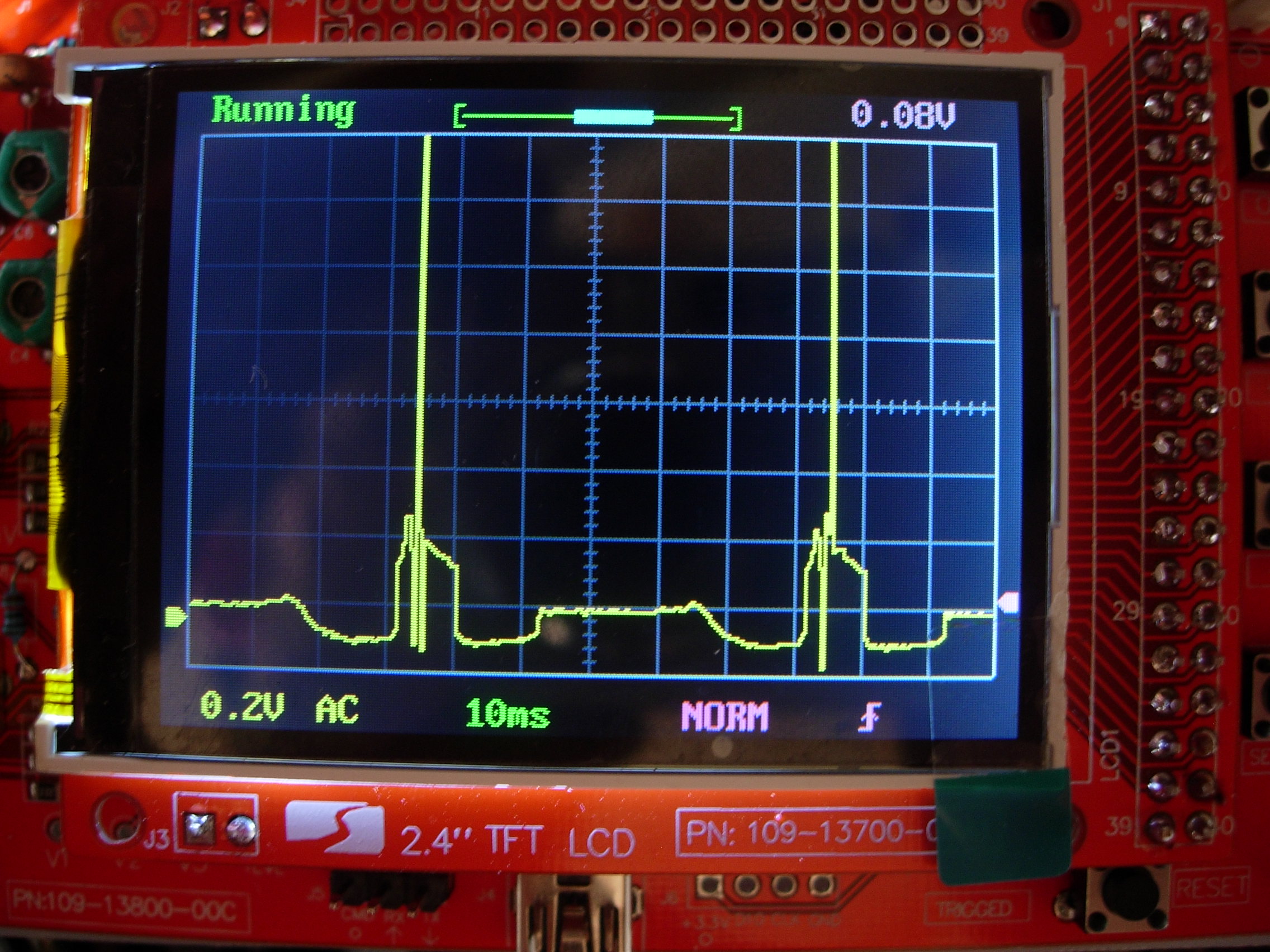

Apart from its small failings im reasonably happy with the units for what they are. Using Normal its like a crude storage CRO, as I was using it to check the wave form of an IGN module I made to replace point & condencer on a Seagull outboard with a Wico Ign system. Once I had a signal I just disconnected it & had a freeze frame of it.

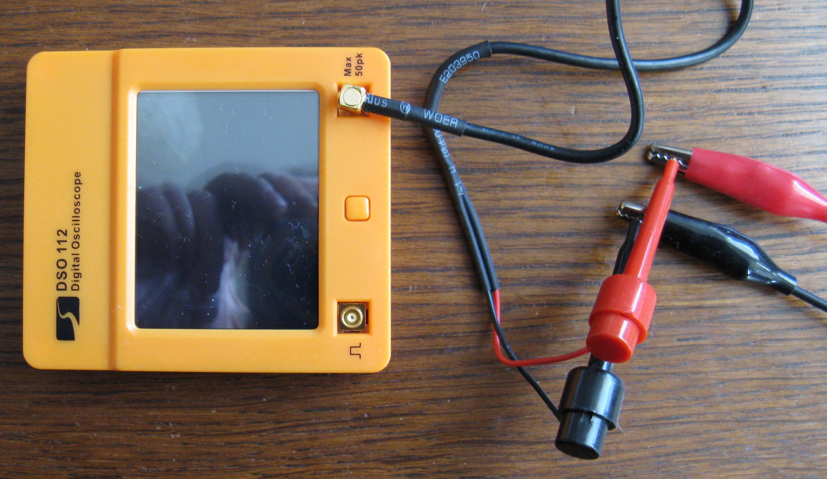

First thing I had to cut off the rubber covers on the alligator clips.
They would not stop slipping.
I will replace the clips with hooks at least on one cable. (sku065700)

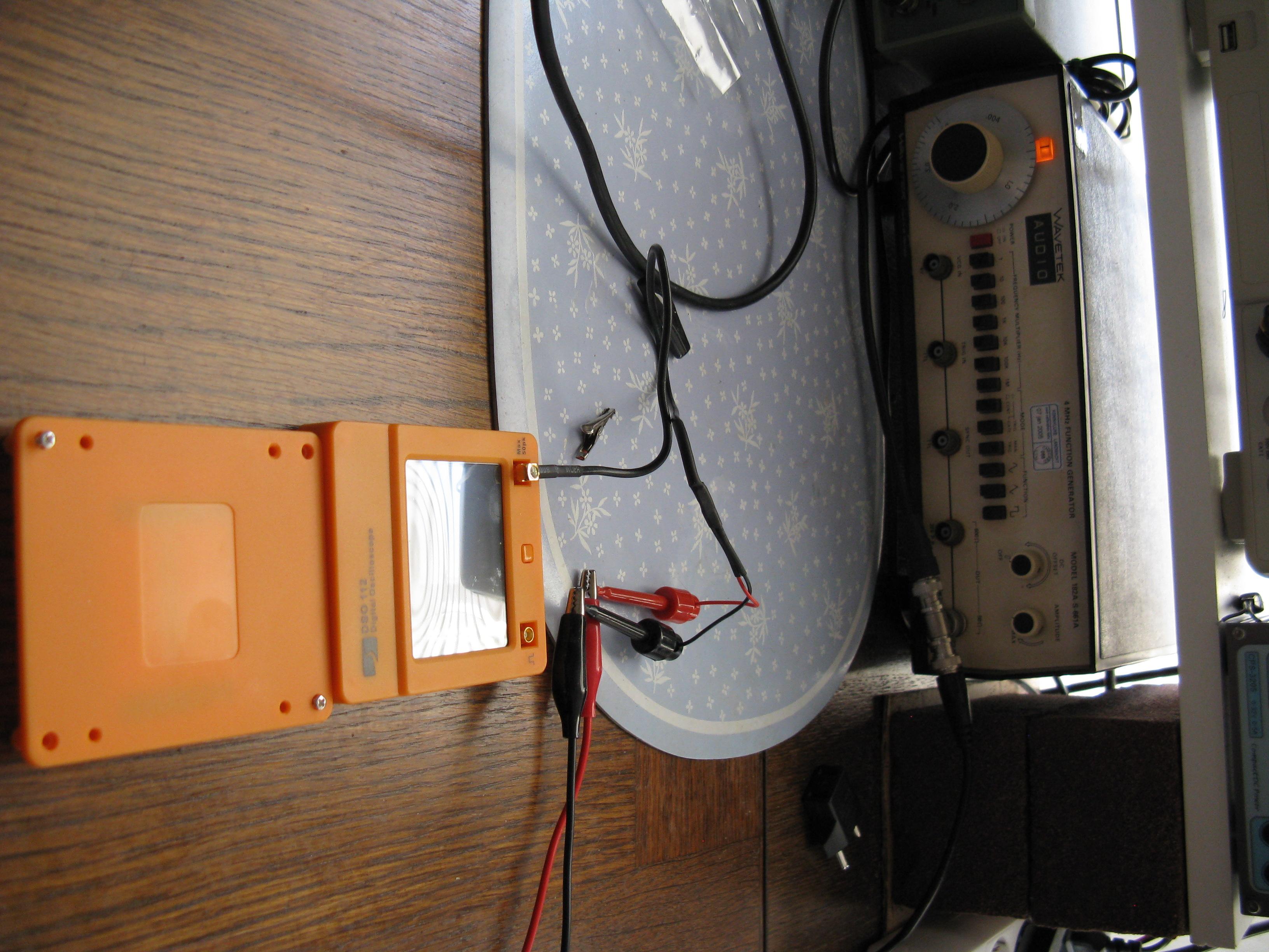

Connected to a good function generator at 2Mhz the trace is smaller
and sine, triangle, square waves look the same :).
At 200khz things are better. Waves are 'better' but the syncing is not stable.
The noise level is acceptable. This scope is much better than the DSO138.

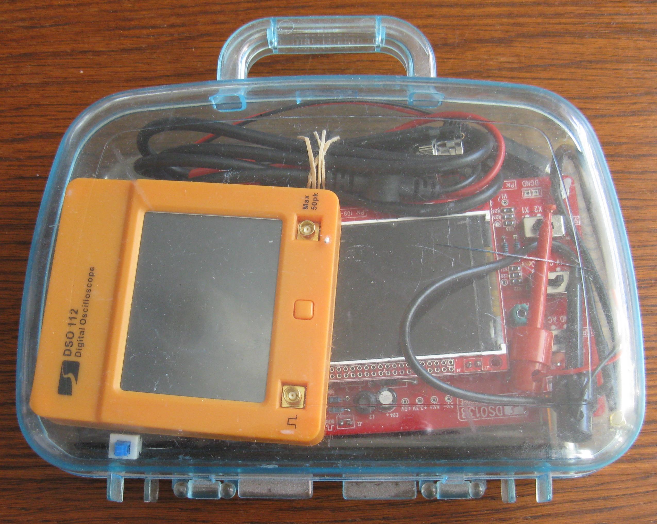

Glad I bought it. I have a Rigol DS1052E for more serious work.
