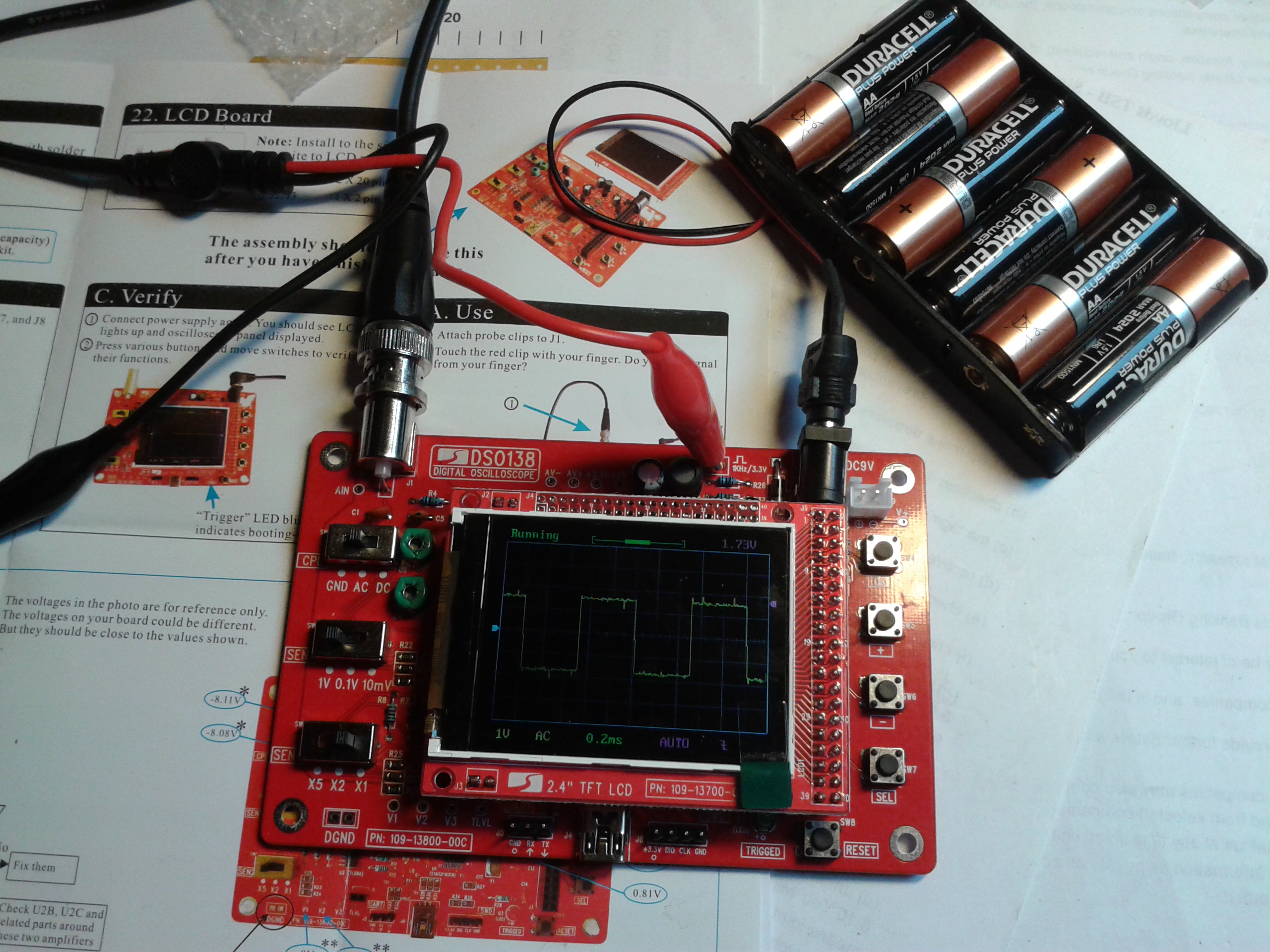

I'm almost through assembling. The 19 TINY smd resistors are taking time. My hands are not steady and this is my first time dealing with these devils. It's a challenge.
OK, it's assembled and working. Yippie!
One nice thing they did to lower the SMD stress is they give you 1 extra resistor for each value.
I got lucky and did not need them.
The Banggood SMD station for ~$20 is worthless. It does not transfer heat. The tip will melt solder but touch it to a pad and it's useless. I used the Hakko 936 solder station (also from Banggood) and it did fine. Set temp to 275c and a pointed M900 new tip for the SMD work. No problem.

Well, it worked for 5 minutes. Now there is no trace. Other parts of the screen are ok.
There is simple trouble shooting flow chart but it did not help.
Edit:
I only lose the trace if I choose a time base of 50 ms or greater.
Everything is cool at 20 ms or faster. Hopefully that will simplify finding the problem.

Here we go! Downloaded the source code and this is in the readme file.
0.37 2015.03.05 Fixed a bug that sometimes causes hang when timebase is changed from 20ms to 50ms

I can confirm that a number of the resistors are indeed surface mount, plus the opamp is as well (just from a VERY brief look at it).
First mistake for me was mounting the surface mount IC round the wrong way. Now waiting for a replacement IC.
OK, had a busy morning starting assembly, got as far as fitting the USB socket - having a rest and a coffee now :D
Getting a bit tired of wearing magnifying goggles :p
I took extra care to make sure the opamp was the right way round, luckily the instructions are very explicit about it, as the chip is a bit vague about pin 1.
The normal resistors are pretty tricky as well, as they are fairly small, and the colours aren't terribly identifiable - so I tested everyone with my Bangood component tester :D
Go back to it in a bit!.
OK, assembled and working :D
Trace seems rather noisy though?.

Yes, it's noisy. I use two 18650 batteries to power it. Has not needed a re-charge yet. These batteries are SO useful.
Got the batteries, charger, two cell holder (with plug) and 20 tiny push switches from Banggood.
Cut the jumper on the battery holder and soldered a switch.
Banggood sells a serial2usb board. ~$6. Waiting for it to arrive and find out if I can program the scope.
The caps should clean up the square wave. Mine is ok.
