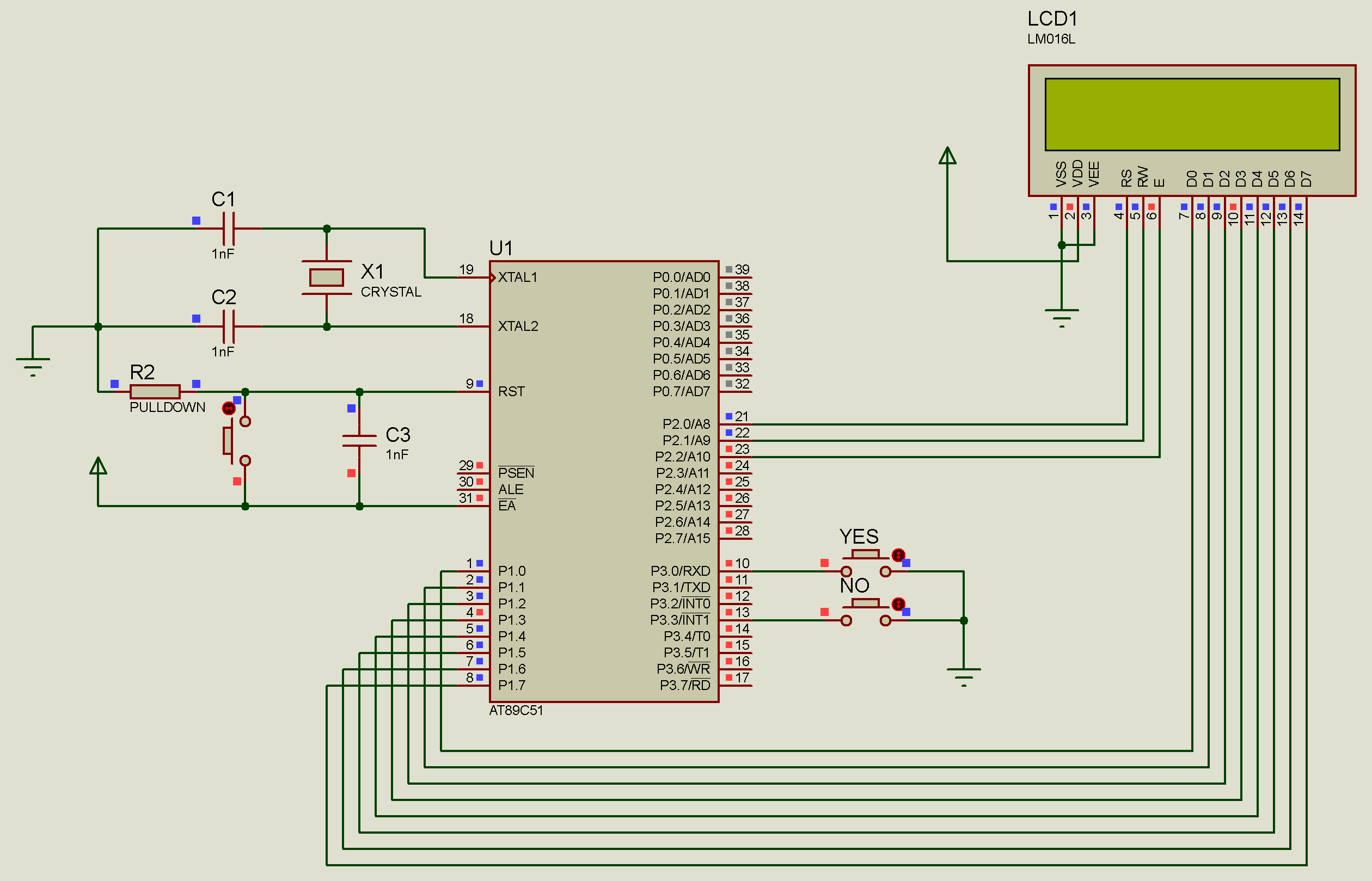

Hello
please look at attached picture there is microcontroller connected with LCD and two input switches.
I want to write c program that will do following things
* start LCD
*display message on first line" do you like dog"
*display message on second line like option " YES NO"
*if I press YES switch button than display message " you like dog"
*If I press NO switch than display message " you don't like dog"
*display message on first line" do you like CAT"
*if I press YES switch button than display message " you like CAT"
*If I press NO switch than display message " you don't like CAT"
* stop LCD
C:
// Program for LCD Interfacing with 8051 Microcontroller
#include<reg51.h>
#define display_port P1      //Data pins connected to port 2 on microcontroller
sbit rs = P2^0;  //RS pin connected to pin 2 of port 3
sbit rw = P2^1;  // RW pin connected to pin 3 of port 3
sbit e =  P2^2;  //E pin connected to pin 4 of port 3
sbit yes = P3^0; // yes button connected to p3_0 pin
sbit No  = P3^3; // no button connected to P3_3 pin
void msdelay(unsigned int time)  // Function for creating delay in milliseconds.
    unsigned i,j ;
    for(i=0;i<time;i++)
    for(j=0;j<1275;j++);
void lcd_cmd(unsigned char command)  //Function to send command instruction to LCD
    display_port = command;
    rs= 0;
    rw=0;
    e=1;
    msdelay(1);
    e=0;
void lcd_data(unsigned char disp_data)  //Function to send display data to LCD
    display_port = disp_data;
    rs= 1;
    rw=0;
    e=1;
    msdelay(1);
    e=0;
 void lcd_init()    //Function to prepare the LCD  and get it ready
lcd_cmd(0x0d);  // turn display ON, cursor blinking
void main()
 lcd_init();
while (1)
what I have to write in main function to do all work ?
