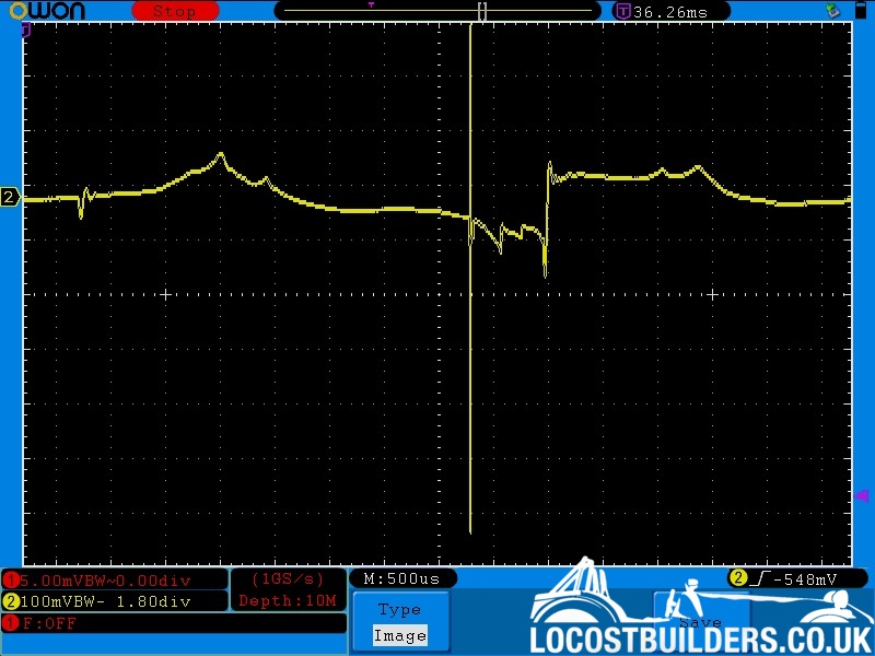

This is an old thread but this may be of interest --- a capture I did of the secondary ignition voltage waveform on a Briggs & Stratton single cylinder lawn mower engine with the solid state igniter. I used a Hantek HT25 secondary ignition probe for the capture.

I have the same probe, its been usefull.
Burn time on that plot is very short.
And this is a small pull start engine, of which I've never done this, maybe I will try it on my mower.
With multi cylinder motors you have a reference to go off, you dont have that with a single pot.
