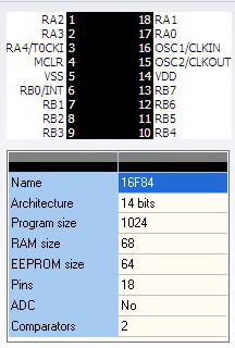

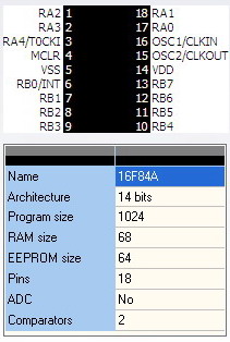

sometimes take a look at this pic give some clearer sight (i did on my 877 and A)
like nigel said it nearly identical :)
'A' is revision from the previous
