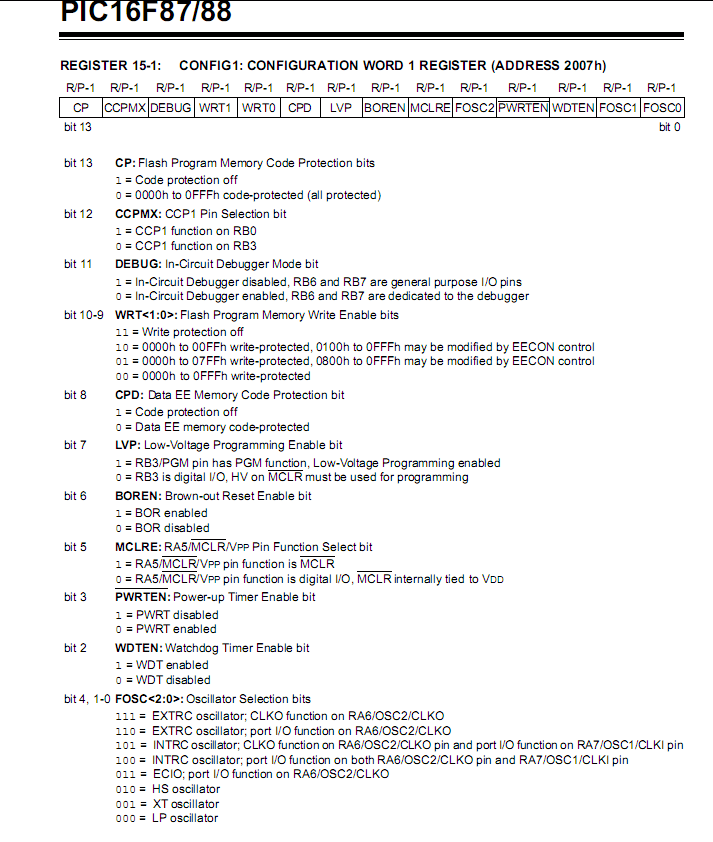

This should be at the start of the source code.
	list      p=16f88           ; list directive to define processor
	#include <p16F88.inc>        ; processor specific variable definitions
	errorlevel  -302 , -207  ; suppress messages 302 [Bank] and 207 [label in column 1]
	__CONFIG    _CONFIG1, _CP_OFF & _CCP1_RB0 & _DEBUG_OFF & _WRT_PROTECT_OFF & _CPD_OFF & _LVP_OFF & _BODEN_OFF & _MCLR_OFF & _PWRTE_ON & _WDT_OFF & _INTRC_IO
	__CONFIG    _CONFIG2, _IESO_OFF & _FCMEN_OFF
Set the WDT, BODEN, MCLR etc to suit your project
EDIT: your error msgs, look at the numbers on BOLD text and check with MPLAB Help for their meaning....
Use this line to supress Warning messages, dont suppress Error msgs.

mr eric, I just found that my wdt is still active and I want to turn it off.
However, I am a little bit confused with CONFIG1 register... It is addressed in 2007h. Can I really access that memory location?
and also, I want to use the internal oscillator and it seems that I will have to set it up again in CONFIG1, not just in OSCCON.
I got this from the datasheet...
bit 4, 1-0 FOSC<2:0>: Oscillator Selection bits
111 = EXTRC oscillator; CLKO function on RA6/OSC2/CLKO
110 = EXTRC oscillator; port I/O function on RA6/OSC2/CLKO
101 = INTRC oscillator; CLKO function on RA6/OSC2/CLKO pin and port I/O function on RA7/OSC1/CLKI pin
100 = INTRC oscillator; port I/O function on both RA6/OSC2/CLKO pin and RA7/OSC1/CLKI pin
011 = ECIO; port I/O function on RA6/OSC2/CLKO
010 = HS oscillator
001 = XT oscillator
000 = LP oscillator
Which one should I choose? I want it to run using internal RC oscillator at 4MHz. is it 100?

It is a text file, with an INC extension thats all!,,,, no problem.

You use one of these options.

You dont access the CONFIG reg, you set the bits in the CONFIG reg
Why dont you do it this way.?? much easier to follow.
Note the BOLD type is the one for the oscillator setting, look at the datasheet for the description

oh okay, thanks a lot, mr eric, you're really really helpful.
and by the way, I wrote my include file like this:
#include <p16f88.inc>
when I wrote #include <pic16f88.inc>, it gave me an error, so I thought I could just change. After changing it, it worked fine.
Once again, thanks a lot.
Regards.
