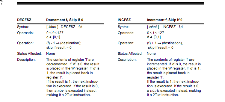

guys, I just realise that I am studying from 2 different websites and they have different theory about decfsz.
one website says that decfsz count,1 means decreasing the value of memory register count by 1.
The other website says that the value after the comma should be a destination address for storing the result of decrementing.
Which of them is right?

Both. DECFSZ decrease the register by 1 and jumps if result is 0. DECFSZ REG1,w will store decremented register in w. DECFSZ REG1,f or DECFSZ REG1 (default f ) will store it in itself, what you want for your delay.
ah, so that means the 2nd website is correct... the first one says that the number after comma is number of decrementing. for example if the count = 50 and the program is decfsz count,2.... the calculation will goes like (50 - 2). but now I have understood it completely. thank you.

The second one is correct. The writer of the first one likely misinterpeted it.
A value of 1(default) writes the result back to the register it was read from while a value of 0 or writes the result to the working register, keeping the original register unchanged.
In MPLAB those values can be replaced with f and w respectively.
It is important to note for the delay that if you decfsz a register with a value of 0, it will now hold 255 (loop around not reset to original).

The decrement or increment of a variable value can be loaded into either the register where its located by using , F or placed in the working register W.
The symbol F or W can be used OR you can use 0 or 1, its explained in the Instruction for dec/inc in the datasheet.
Regarding the the servo, if the servo output arm is driving against an external force, say a model aircrafts elevator, if you remove the 20mS refresh from the servo's position the wind would blow the elevator back into a neutral position.
It really depends upon the 'load' the servo is trying to hold in position....OK.?
