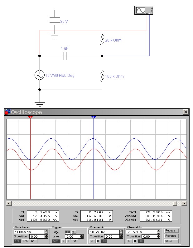

DC biasing to offset an AC sine wave to a positive values
It somewhat depends upon the source of the sine wave and what you want to do with it.
In general you can AC couple the sine wave through a capacitor and bias the output of the capacitor to the desired offset voltage with a resistive divider to a plus voltage and ground using two resistors. The rolloff frequency of the equivalent divider resistance and the capacitor should be well below the lowest frequency you would see.
The 12V 60Hz sine wave is from a stepdown transformer.
I tried using the cap followed by a voltage divider, the cut-off is at 15Hz which is well below my 60Hz, blocking the DC component. But tried it on breadboard, it stays at the same voltage no matter what AC signal i couple in. Maybe my voltmeter could not measure this correctly.
If you are using a DC meter, it will read the average value, which is just the bias value. Try putting the meter in the AC mode. At least you should see the same AC voltage as you are putting in. In the AC mode, the meter will block the bias value.
See the attached.

Why both your oscilloscope are set to DC? Vin should be AC?
can i use 0.1uF?
If the oscilloscope was set to AC then you wouldn't see the DC offset of the output. AC means the scope is AC coupled and does not see DC.
You can use 0.1uf if you also increase the value of the resistors proportionally to maintain the rolloff frequency well below 60Hz. My example has a 9.5Hz rolloff so you would have to increase both resistors by a factor of 10 to maintain that rolloff.
