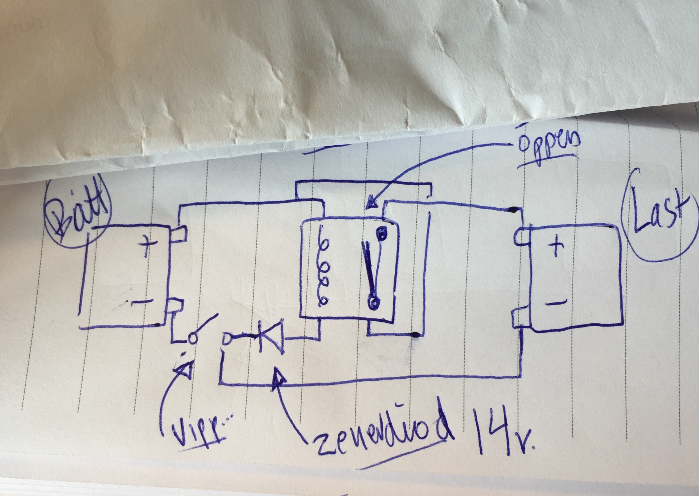

Im working on a portable boombox powered by four panasonic NCR 18650B, 3400mah cells in series. I bought a PCB and I have a small 4s balance charger. The PCB will be secondary if anything fails and cuts voltage at 3v.
Thats to low for me during daily use. I want a primary cut off at 14v (3.5v *4). I was thinking maybe this can be done with a zener diode and a relay? Something like my image illustrates it. (Sorry for the swedish in the image)
Translation in image:
Öppen=open
Last=load
Batt=battery
Vipp=on/off
Dont know if its a good idea? Or is there any other simple way of doing this? I'm not very good at electronics but understand some basics and can solder. Appreciate any answer.
Thank you!
