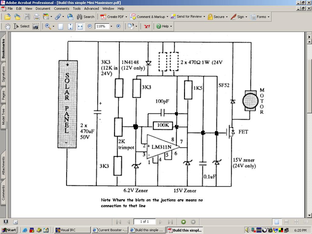

    Reg: Question in Maximiser
    Hello Bryan,
    In the maximiser ckt. the 0.1 microF capacitir (which is connected to the FET) is also connected to both the terminals of 1.5K!
    There could be something wrong in my statement or could be in the image. Could you go theugh it and confirm where exactly the Cpacitor terminal is connected?

    Reg: Probable Error in the maximiser
    Hello All,
    I have come up with "probable" corrections in the ckt. Diagram given for the maximiser at : http://www.voltscommissar.net/minimax/minimax.htm
    1.
    Acc/to the diagram the 2K trimpot is connected to the junction where 3K3, 6.2V Zener, 100K, 100pF and Pin 2 of LM311N come together.
    In this case the 3K3 and 6.2V Zener junction should be separated. That means there should be a jumper which will connect Pin2, 100K and 100pF to 2K trimpot and will cutoff 3K3 and 6.2V connection. (I hope this makes clear what I want to say!!) Otherwise, pins 2 and 3 of LM311N will be shorted.
    2.
    Same applies to o.1microF and 1.5K connect. If 0.1 :mu: F is also connected to Pin7 of LM311N then 1.5K gets shorted.
    Please let me know if I have gone wrong somewhere. Or I am getting overconfident about this.
    Warm regards,
    Amitraj
  20. amitraj
    amitraj New Member
    Joined:
    Mar 23, 2008
    Messages:
    12
    Likes:
    0
    Location:
    Pune, India
    3
    Pin 8 and 7 are shorted through 100pF and 100K.
    jumpers are required at both the junction point. i. "100pf and pin 8" & "100K & pin 8"
    Please correct if anything faulty here.

    Hiya amitraj,
    Below i've ammended the schematic to show you where some lines cross they aren't connected. It is an error on schematic as usually a small raduis is put onthe line to show no connection.
    Cheers Bryan
