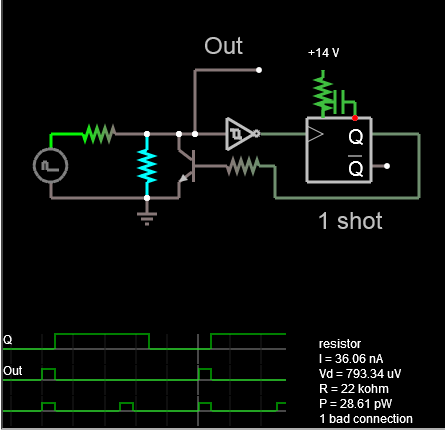

What happens to the double pulse train as the engine rpm changes?
This is proof of concept only of a Pulse "swallower" as they are called.
85V pulse is attenuated for either 5V or 15V logic (CD4xxx) and squared up and inverted with a Schmitt Trigger.
The Input trailing edge is now rising edge and triggers a Monostable or 1-shot.
The Q output drives the transistor to clamps the 2nd pulse to ground for about 250us after the trailing edge.
If it is the 85V pulse you need to drive the analyzer, then move collector to input.
I dont see any difference in detonation. why is that?

Filtering might detract from the ignition analyzer functions.
Some 1shots also have negative edge triggering, so the inverter is not needed.

Tony... Not sure what you're asking about the detonation. But in any event, I DO need the 85 volt pulse, so I'll try your widget moving the input to the collector
Oh... and this unit IS operating on the rising edge, FYI.

Al... that picture is showing the waveform before and after my filter (top is unfiltered, bottom filtered). I was in essence trying to do what you've described, but I moved my resistor past the capacitor so as to only affect the discharge time. Maybe that concept is just off... so I'm going to try just a true-blue RC low pass filter built in the traditional sense to see what it yields. Because of the nature of this device, timing is pretty critical, so I was afraid putting the resistor ahead of the capacitor would start sliding me in the time window. My original design incorporated a diode also (just not the second resistor you mentioned because I didn't want to time the charge - I just wanted it to charge as fast as it could).
Hope that makes sense.
Yes it does make some sense, but what is driving that cap then?
Sometimes you have to have a buffer between, and that wont slow anything down.
For example, have the input turn a transistor on and off, and then the output of the transistor can be used for the filter drive signal.
MrAl... That is exactly what I'm ending up doing. I'm using the double pulse to switch a mosfet (actually 2, because I need to first switch an N-channel [positive gate], so I can switch a P=channel [positive source])... but it's working (almost). What I've ended up with is a sort of round humped stair stepped additive pulse. I'm going to add to the resistance of the charging circuit today and I think that should get the charging ramp more or less linear...just have to play around with the resistance values. I ordered some pots because I'm tired of switching out resistors on my breadboard. :)
