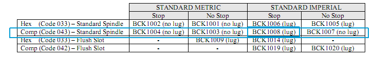

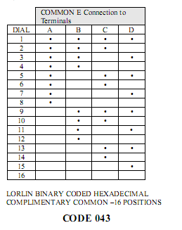

Will a Lorlin BCK1008 do the job for the switch i.e. 0-16 in a clockwise direction - it seems I can get hold of them
Regards
Mark
hi Mark,
OK, had to relook!
Its the type we wanted initially.. HEX Complimentary
So fully anticlock its '0' portions then 1 ,2 thru to fully clockwise 15 portions.
