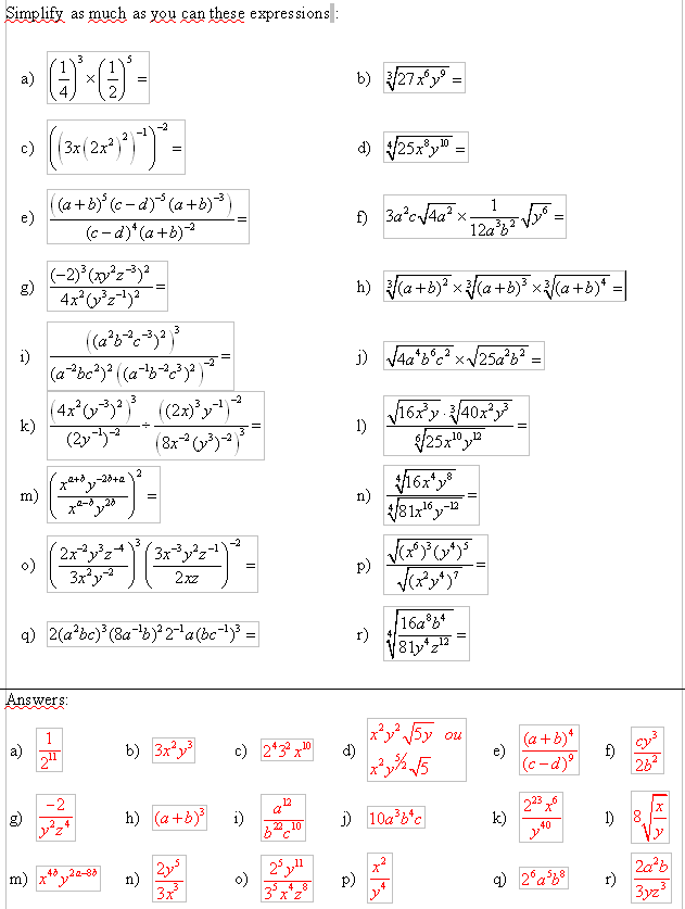

I e-mailed the prof in order to get a homework, if any there was and he sent me this.
Now, I just want to know the right name for this in english please (the course is in french!( so I could go on and study tonight and this week-end.
Looks complicated but I'm sure it's so simple and I want to enjoy doing those maths... and will hopefully find YouTube videos and stuff :) with the right subject to look for lol
thanks a lot !
This is all about 'indeces'. (plural of index)

Yes it does in fact help, thank you very much. I was able to figure it easily but it's all far back in my head.. but I kinda remember the rules with the exponents. I always found the roots to be difficult but I think it will be understandable this time.
At this point, I need to re-learn how to do, for instance, this: (-8,8) & (-3,-5) to y = ax + b
I know it's a slope and it touches the coordinates.
and as I'm writting I'm think, it probably has something to do with "y2-ya1/x2-x1" ?
Roots are simply fractional powers, positive or negative.
I always found drawing the graph if it's simple gives you a better understanding.
Well I thought it was easy but I must be doing something wrong because the third one, ( C ) is quite not what I come up with when looking at the answer.
How can he get to x^10 ?
This gets solved from the inside out.
Starting with x^2 in the middle of the whole thing, that gets squared so we get x^4, that times the outside x is x^5.
The inverse of x^5 is x^-5, and the inverse of that is again x^5, and that taken to the second power is (x^5)^2 which is x^10.
The constant comes out to 144 so we get 144*x^10.
