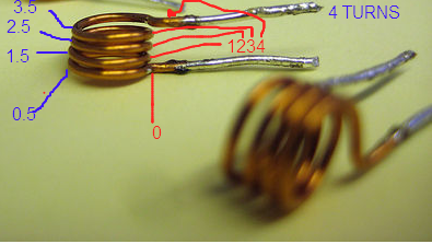

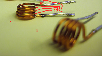

Hi there .just a little question regarding coils .on my schematic it says 5 turns .would the half turn at left end and half turn at right end count as a turn ?
yes,
The 1/2T at the left and the 1/2T at the right, If that was all you had, would you have one turn?
Do you have a picture. I don't see your point.
If the coil made by the wire makes a full circle, then it counts as one turn.
Nothing is connected to the top of the coil so there are no half turns. The coil shown simply has 4 turns.
Ok thanks guys just was a little weird on the count idea.ive now got it thanks for your help in time and effort there thanks well appreciated
