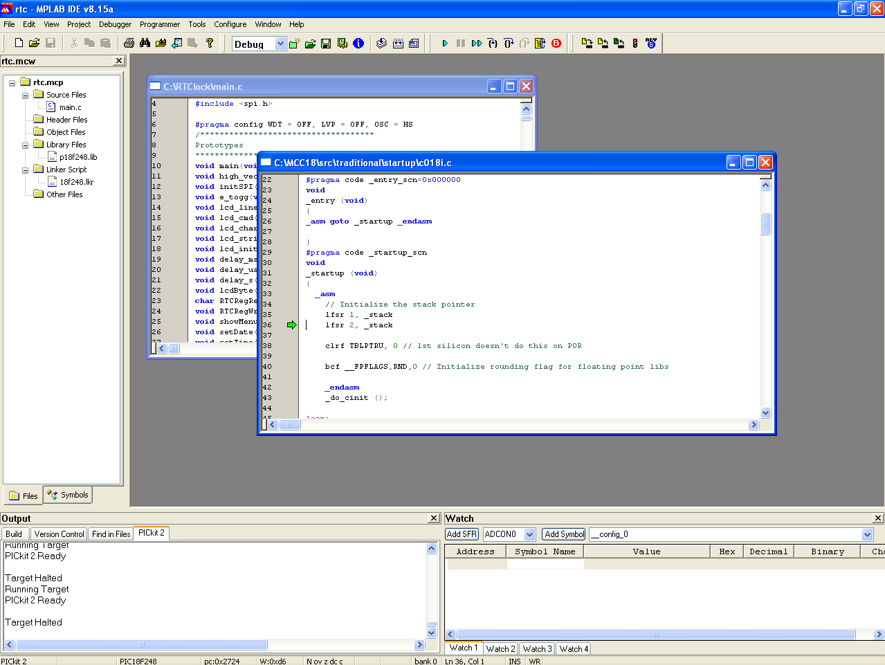

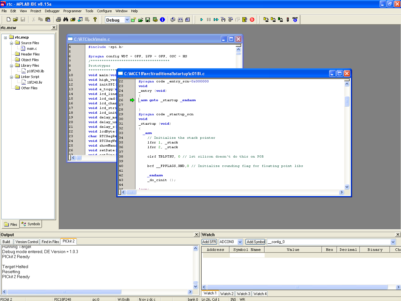

OMFG i hate this... every time i press play it breaks. Like i put a break point. I think its that BUG in MPLAB.
EDIT: I redid the project by erasing all files besides the main c file. It still does not run a all. Here is the main.c now. Can anyone figure something out please. :(
The path is "C:\RTClock\main.c" so i know its not a filename issue.
  • main.c
Here are images showing it. The first image is when its reset meaning after a compile.
The second image is after i press RUN the green arrow shows where it stopped.
The third image shows after i press run again it stops at green arrow.

I got it working so far so good. I changed my breadboard for the button since that was causing a ton of glitches and false input. I also put pull down resistors on the rest of portb(RB7:RB5).
I changed my buzzer since i noticed (late) that its a 12v Buzzer to it was pulling to much i guess. I went to radio shack and bought a 1.5-3v 15mA buzzer and put 2 470 Ohm resistors as a voltage divider. Hoping that they would give me 2.5v @ 10-11mA.It works well no issue.

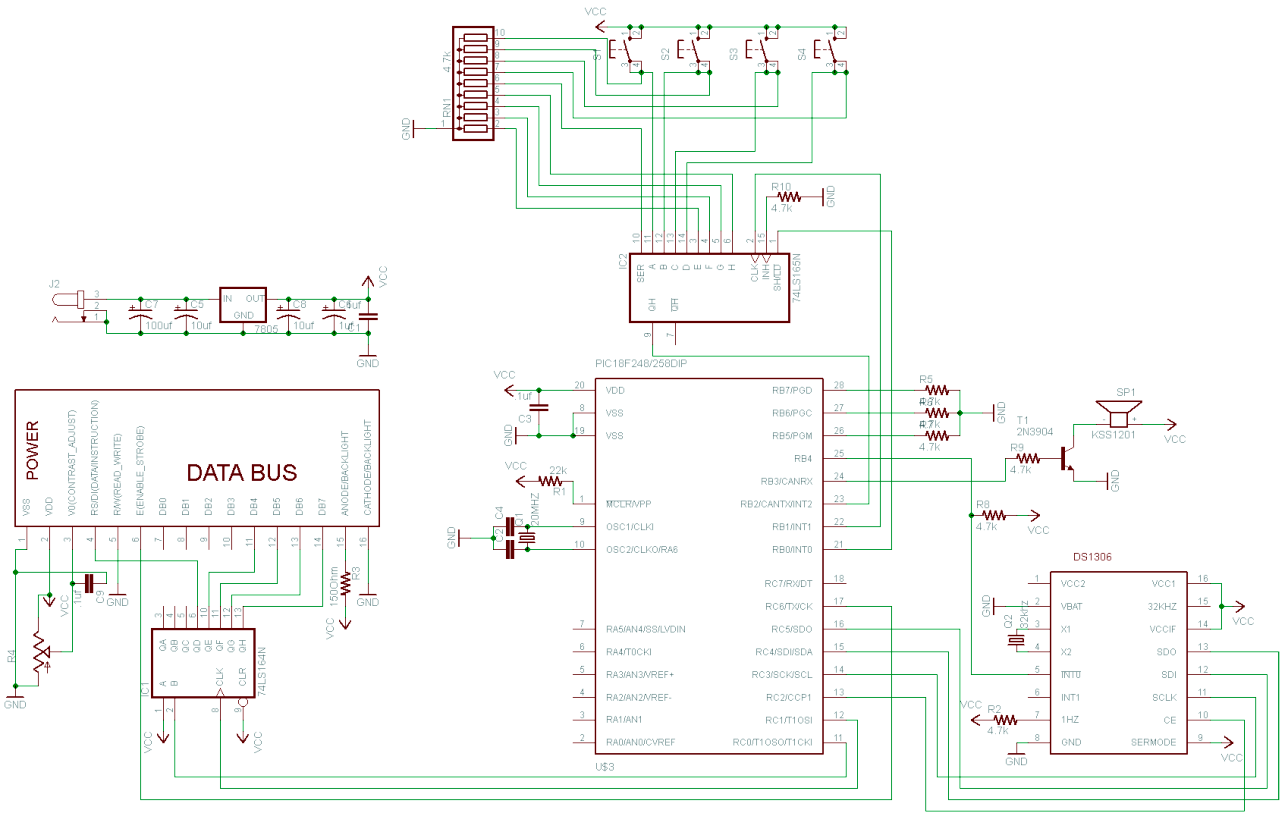

I changed the buzzer because when it rang the whole thing crashed. Now it buzzes fine and i even made it so you press enter to silence it. Anyway here is the full code and a schematic is coming in about 5 minutes.
I freely give my code out mainly because everyone here helps so much and i say this belongs to anyone who wishes to learn or earn. And hopefully it will help someone who need a example of something.

Here is the updated schematic... BTW i am going to try my best to go back to school. I think it will be the only way to move up in life in my own opinion.
I put the schematic and the code in 1 zip file. Its a eagle schematic and a PNG for those non eagle-ers :D

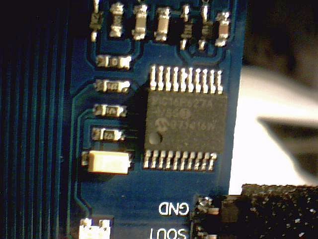

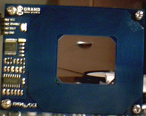

Hey 3v0 a friend just came by with a gift for me. He went to radio shack and got me:
Its cool.. but it comes with only the RFID reader, 1 card and 1 Circle thing. The Card and circle thing are 2 different tags. Now i have something new to play with lol Just in time too. Its the Serial version. Now i can use the pic with ease on it. Noticed it has a 16f627a on it.
yeah I've known him for about 10 years now and im 24 so since i was 14. He knows i love gadgets and such.
i was calculating some stuff off the datasheet for it , and its 2400bps which is fast enough to read an ID about 25 times in 1 second which is pretty fast. thats about 1 in 40mS.
Since it has a 16F627A(SSOP) i figure i can get another and one and program it to work at higher speeds.
