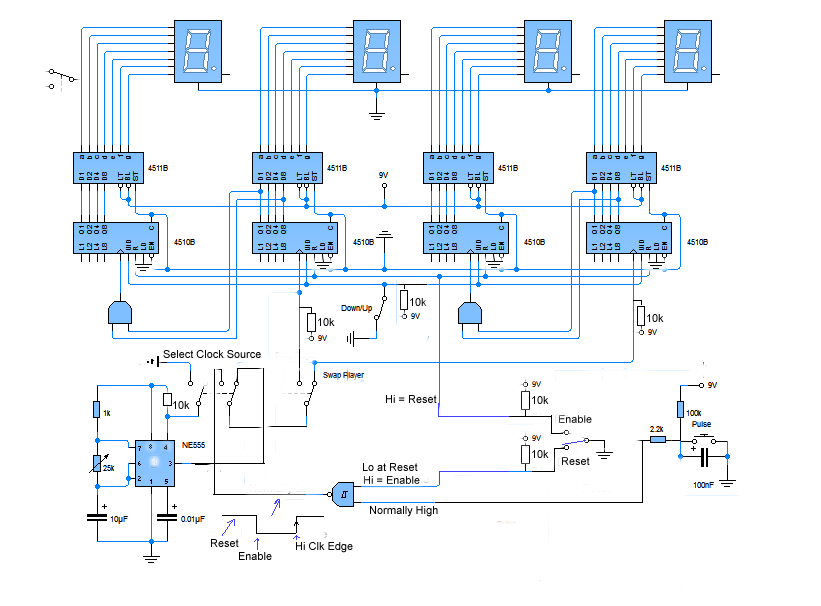

Oh I get it, so like this then ???
Consider this option, use the 555 RESET pin #4
As I said before the use of a diode on the output is bad idea, rethink it.

Look at this option.
Brilliant, works good as new. Could I ask, what are the resistors for?
As I have said a number times, 'floating inputs' to the IC's
A CMOS IC input pin has very high input impedance [resistance], so if left unconnected it can pick up a static charge, this charge could be high enough to register with the IC as a genuine input High.
Just moving your hand near the circuit board can effect this static charge and the circuit will malfunction.
To prevent this problem the input pin is connected to +V or 0V via a pull up or pull down resistor, depending upon the IC's function,, the resistor holds the pin at +V or 0V whenever the pin is unconnected to another part of the circuit.
OK?

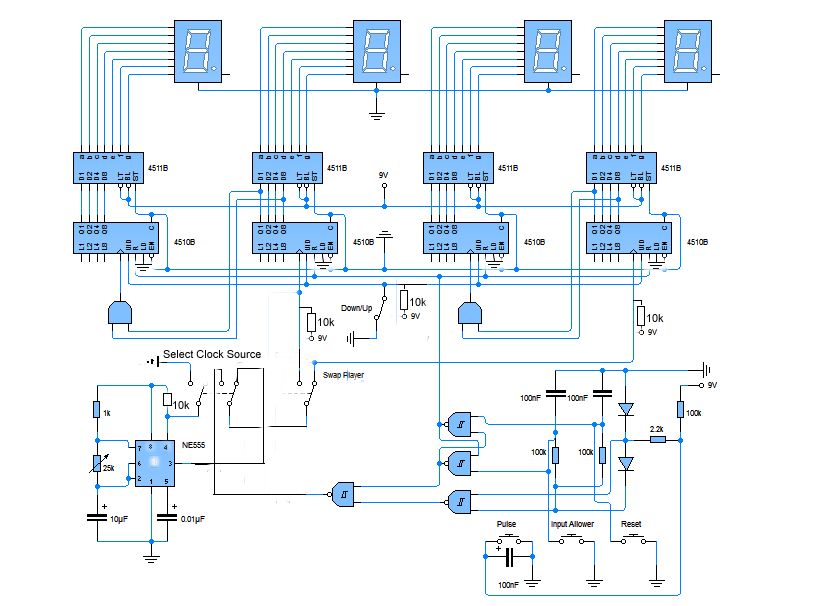

hi C,
Look at this option for enable/reset and clocking.

Thanks MikeBits for the new knowledge but for the perpose of making a simulating schematic I can't really do that :) Thanks so much anyways
Oh yeah, I'll look into that thanks eric
One other point where are the current limiting resistors for the LED Displays.?
Also have you looked at the/TC pin 7 for carry/borrow.?

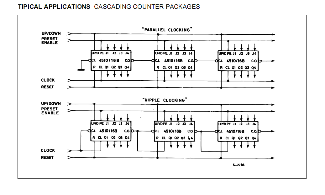

When you cascade 4510's to form an Up/Dn counter you can use the existing pins on the 4510's rather than AND gates.
Look at this image, I prefer the synchronous/parallel method of clocking.
Google: Cascading 4510 for more info.
