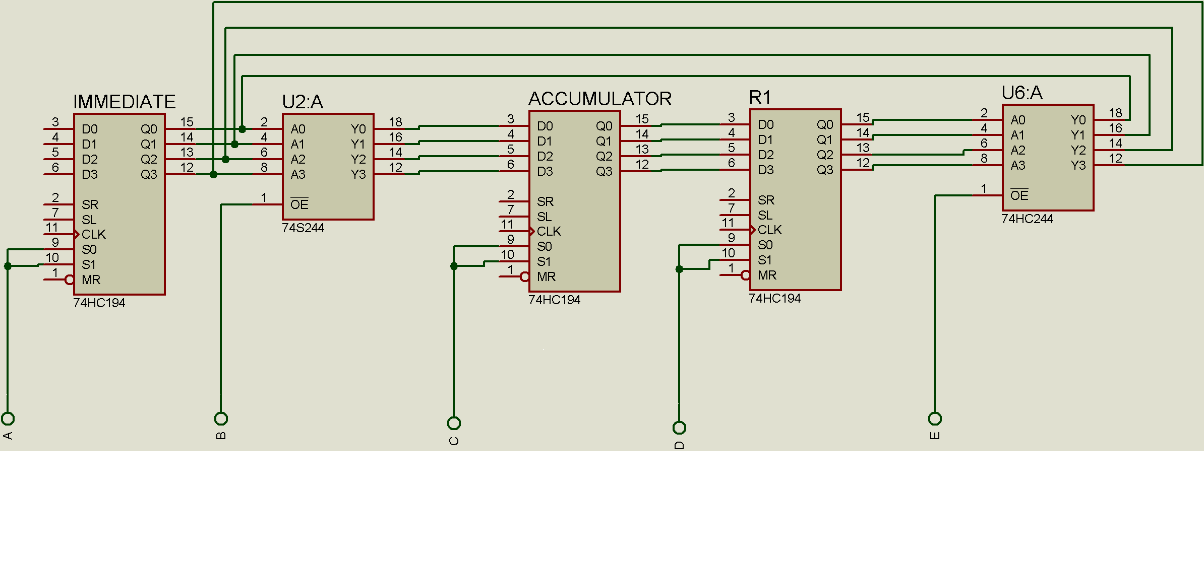

look this picture. this can executed three instruction
MOV A,#immediate data
MOV A, R1
MOV R1,A
MOV A, R1
MOV R1,A
how many cycle I need to execute these instruction?. I think ,two because I don't need to decode signal. to execute the instruction we can fetch and directly execute instruction

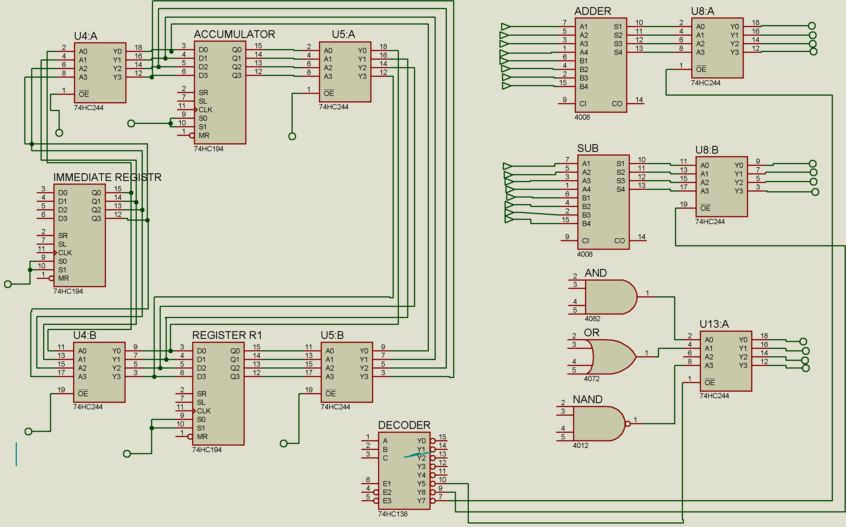

please check capability of circuit.
can we execute following instruction with this circuit
load ,store ,arithmetic and logic instruction
Note : I did not use 2 input 4 bit logic Ics. I don't have this Ic in software
How to improve circuit ?

please help me , whats wrong with that circuit. just tell me few mistakes. I will modify the circuit. please help me
