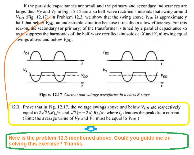

Please help me with the exercise about class B power amplifier. Thank you.
