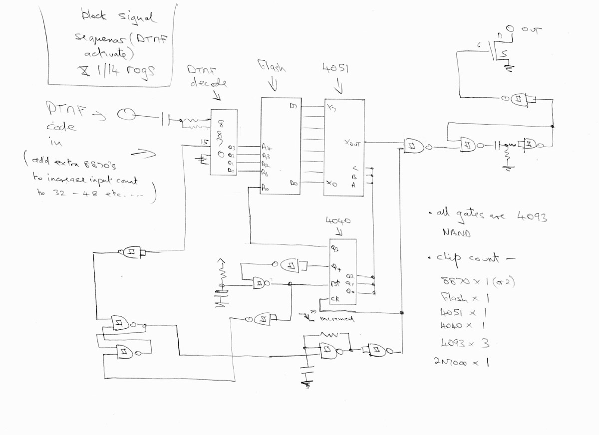

24 momentary switches can easily be setup in a 4x6 array using 10 I/O pins and no additional ICs.
Your comment got me thinking about a keyboard matrix option... and that led me on to considering a DTMF keypad... and the cheapest version of that is probably an old telephone.....(well to test out the concept anyway!)
Now, if you do use DTMF as the switch instructions, then the hardware gets even easier ( and cheaper!). Concept sketch of that idea attached..... (just add up 3 more decoders to extend the input switch count up to 64, if required)..
(I'm determined to prove there is a viable hardware option :) )
Of course, if the OP wants to use this project to learn about uCs anyway?.......
rogs:
I understand the addressing, but how are you doing an arbitrary length sequence with two different delays.
Attention is 1 bell and a space. this space should be longer than the code, I think.
S, you get
ATTENTON
16 bells+delay for the command
or
ATTENTION
4 bells+delay repeated 4x
A few commands don;t get the attention signal.
This is like morse code.
As I say, it's just concept sketch.... no point in doing any detail if it's not going to get built!........ :)
Re: the timing..... at the moment, It's drawn with just A0 connected to the flash address buss.....
...Valid code received, is latched into the 8870, and presented to the flash data buss. Valid code flag (pin 15) goes high on the 8870, sets the RS flip flop, and starts the clock.
The 8 'bits' of the flash word being addressed(whether they be highs or lows) are scanned through the 4051 by the 4040 counter. (Q0 - Q1 - Q2).
Q3 is connected to A0 of the flash address, which then goes high after the first scan, and lets the next stored data word be scanned through the multiplexer as well.. When Q4 goes high, the system is reset until the next valid code.
If it's necessary to use more flash 'words', to allow for different timings (say 'hi' for one count for the bell and two 'lo' counts for a space?), then simply adding the Q3 counter output to the flash address buss as well - and resetting the system from Q5 instead - would allow 32 time 'slots' to be read... which could be programmed as required, to get the timing 'right'.
It would of course mean that the 'space' timing would need to be a multiple of the 'bell' pulse , but the few examples I have heard online don't suggest it's that critical (the sequences were entered by hand.... like manually keyed 'Morse Code', as you suggested.)
Examples - about 25 seconds into this video:
or the first 30 seconds of this one **broken link removed**
Certainly those samples seem to have a typical 'gap' timing about the same spacing as the bell.
Although of course the monostable connected to the multiplexer output needs to be adjusted to allow the bell 'hammer' (solenoid?) to strike, and then fall, much more quickly than the whole time period, to allow the bell to sound 'right'.....(just a short 'ping' of 100 - 200 mS, I suspect?)
So, it would simply be a question of adding longer programmed sequences into the flash. (say 32 per sequence instead of 16?). You could go further and make it 64 -- there are plenty of counter outputs, and spare flash locations to address!...

@ rogs
I've been suggesting individual switches, you have been suggesting multiplexing switches.
.......He is apparently in the uk........
I'm in the UK too, so recommending component suppliers might be easier?.....:)
I started out suggesting individual switches ( see my sketch in post #36), but other posters suggested that a 'matrix' might offer a better solution when using the uC option ( see post #44) .. so I included a cheap (DTMF telephone) sketch option for that in my post#48.
Individual switches obviously offer the most flexible option......
At the end of the day, LeedsNorth has to decide whether a software controlled uC system, or a simple hardware option is the way for him to proceed with this project.
Further suggestions involved with progressing design details in both directions simultaneously is only going to confuse....because they are likely to be so different!
I certainly don't feel inclined to get involved in any further 'point scoring' exercise over which option is 'best'.. (I'm probably guilty of that already :))
If LeedsNorth wants to consider the hardware option, then I could maybe take the next step, and add some detailed pin connections to my earlier concept sketches?....
But if he decides he would prefer taking the uC option... then it's over to you software guys! ....:)
(Not an easy decision for an electronics 'newbie' to have to make...:arghh: )
