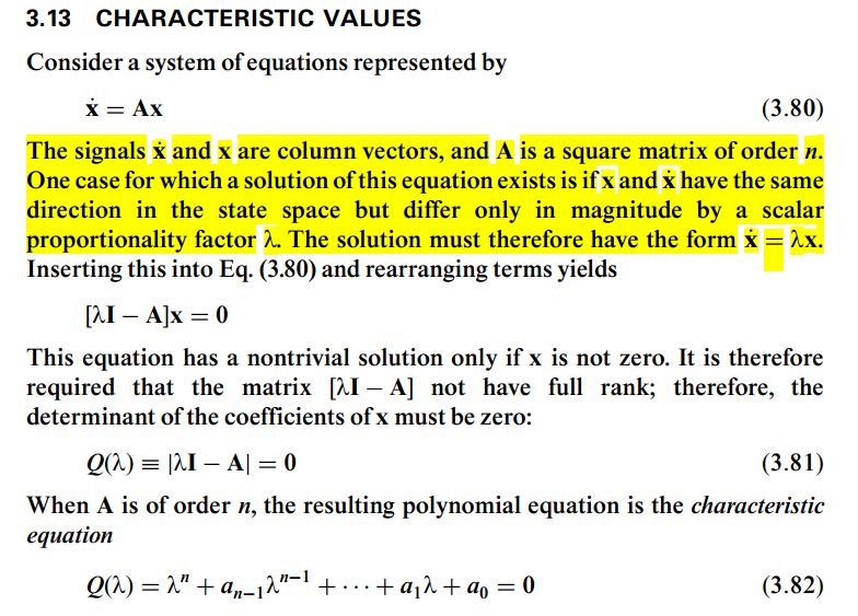

I can't understand the reasoning about the solution:
characteristic-values-jpg.75039
Can you help me explaining it in more detail?
explaining what? just the highlighted part? it is basic arithmetic:
xdot = A*x
where xdot = lambda*x
therefore we can write
lambda*x = A*x
lambda*x - A*x =0
note that lambda is some proportionality scaler (which we call eigenvalue) er can write
[lambda*I -A]x = 0

That's because this is the state space representation of the equations.
