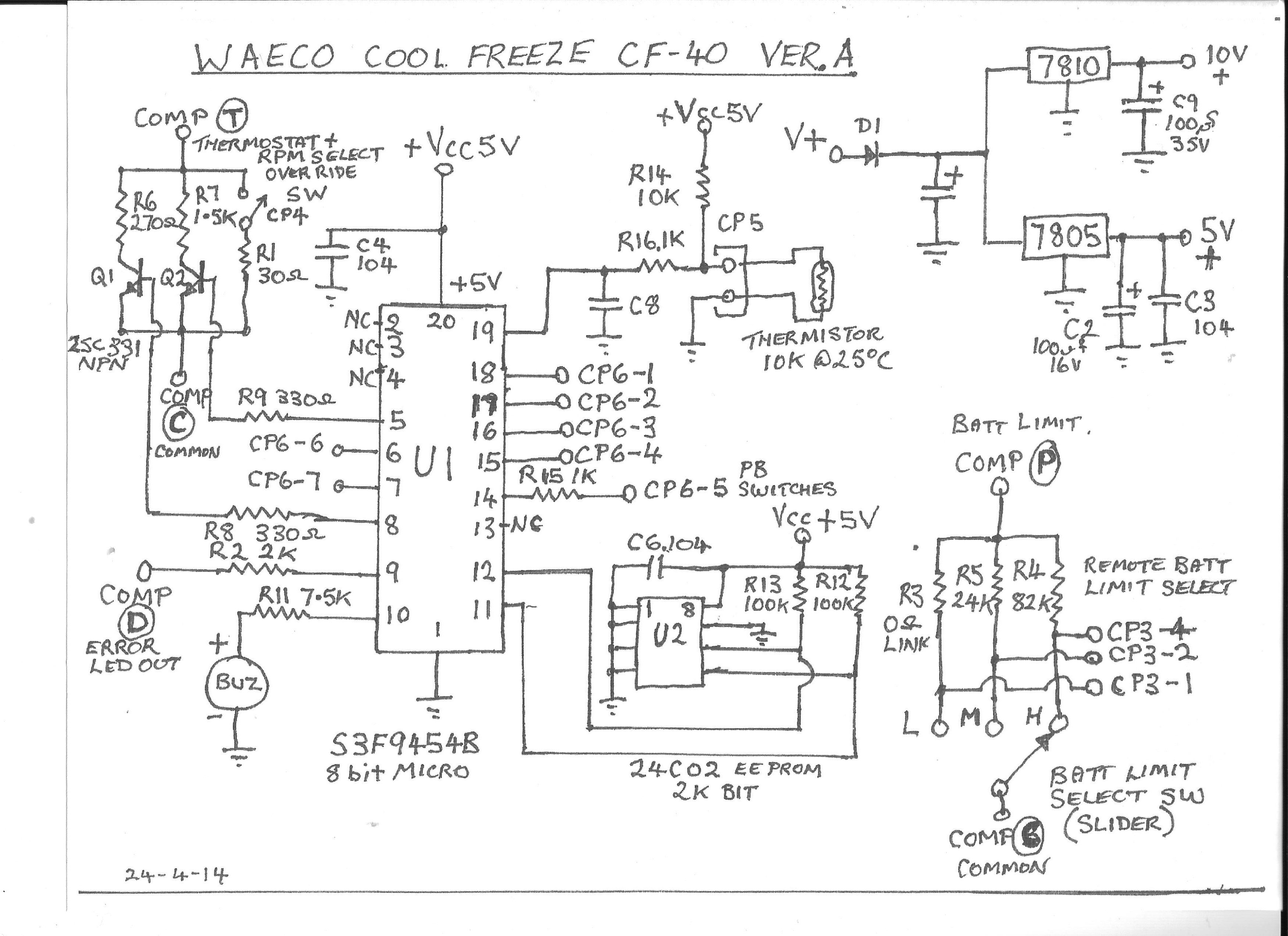

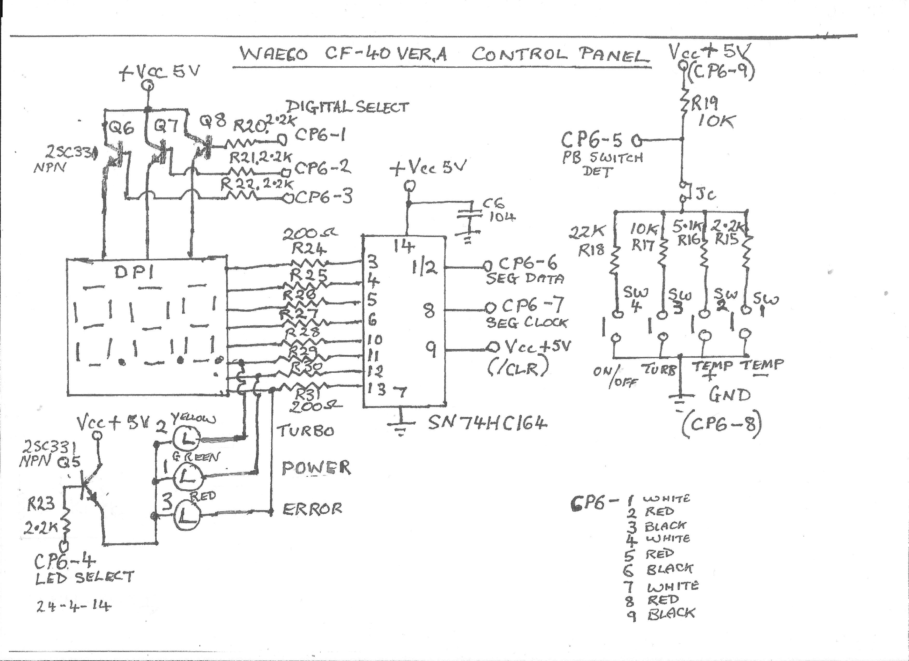

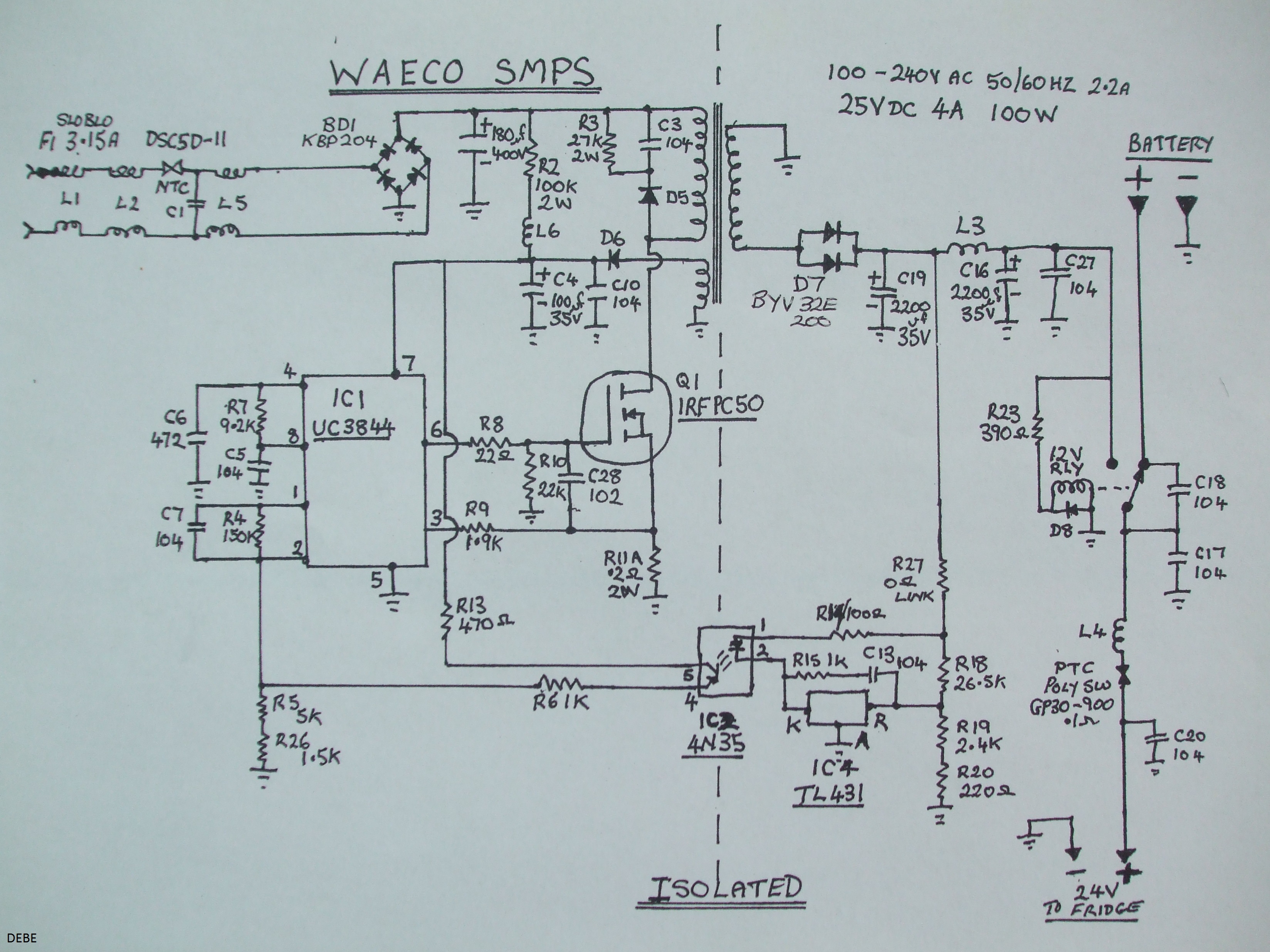

No its not Ian, there was text but it disappeared & double the pictures for some reason. Its my fridge & I drew up the circuit for it as theres non available. Just it may be helpful for some one.
