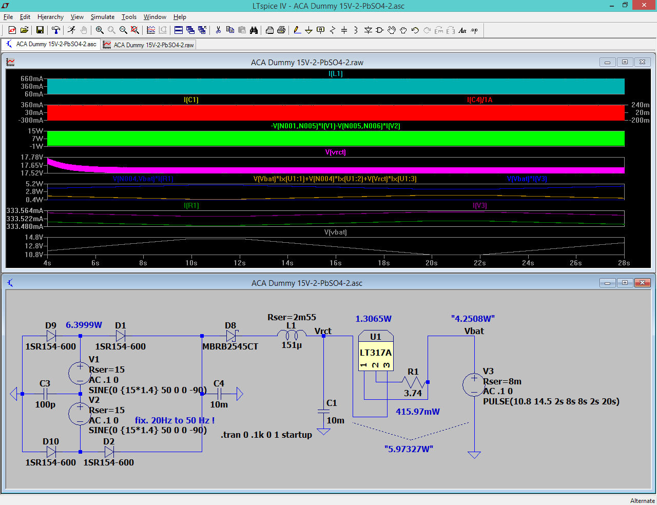

the first simulation shows the optimistic max. for the constant current from the 1.0 A 15-0-15 V TF using the LM317 as a regulator
the second shows microbe-hour comparator use to switch modes -- however . . .
