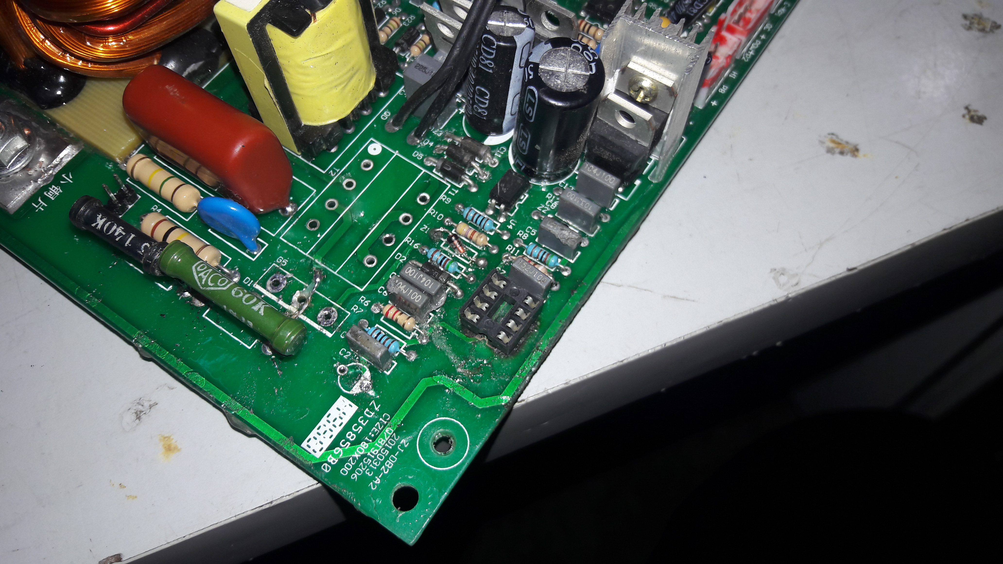

I am troublshooting a device with 2 power supplies a high power bridge and an auxiliary one using the uc3842 ic.
I have changed the ic with a new one and checked the aurrounding circuitry .
I noticed that the ic Vcc supply fluctuates between 12 v dc and 14 v dc
and a bad output signal.
Can the supply rail be the problem ?
If it's fluctuating it might be a sign of a faulty rectifier or failing smoothing cap.
If possible, I would try to test the pwm circuit with a stable input supply.

Hi thanks for the hints. btw i have an lcr meter with dissipation factor D for capacitance.

Hi again am working on this board again.
I have changed the electrolytic capacitor feeding the uc3842 , also repaired two 100 kilo ohm power resistors giving supply from main Dc bus , and i still have bad signal on ic output.
i also checked the rt, ct circuit and the optocoupler circuit.
mystery.
This is the auxiliary switcher :
what do you mean by bad signal on ic output?
this chip has 2v5 feedback comparator for voltage and 1V comp for current sense. It should oscilate on full duty cycle if its not above this voltages
