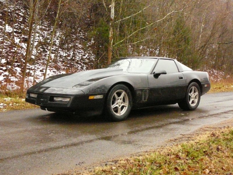

here is my car, which I have wanted for 15 years now before I could afford it.
can somebody please help me build this? it is beyond my knowledge, but it sounds like it is easy to do for somebody that knows electronics.

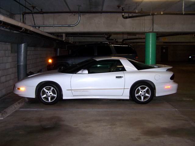

I'm guessing that you want to restrict how a third party treats your vehicle, such as a parking valet (or a son/daughter). Or you want a way to detect when it's taken out of gear (intentionality of not) without putting switches on the transmission/clutch.
Looks like we have similar taste in cars. What year is yours? Mine is 96.
