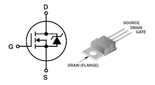

How does an SCR compared to a Mosfet?
I need a 100KHz switch.

SCRs are not fast. 100khz
Mosfet can be turned on or off at any time.
SCR can be turned on at any time but the turn off can only happen at 0V or reverse voltage.

SCR's turn on and dont turn off until the main current drops to near zero.
MOSFET's can be turned on OR off at will with the gate voltage.
SCR's used as switches in certain products can be made to turn off at regular intervals with commutating circuits containing inductance, but it's more complicated than using MOSFET's or IGBT's.

Will a signal generator do that? When signal is + SCR turns ON. When signal is - SCR turns OFF. Is it that simple, sine wave from signal generator will turn SCR ON/OFF at what every frequency is selected?
