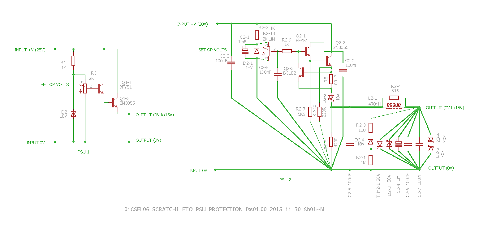

In terms of protection, bench power supplies are some of the most difficult: quite simply, you never know what will be connected across the output terminals. Because of this, they are also difficult to stabilise in the frequency domain and at the same time give good fast regulation. This is not so difficult with the low gain Darlington output of this simple voltage regulator, but even emitter followers can make good oscillators.
So, out of interest, I took the most basic voltage regulator, the kind that was popular before the three terminal regulators, like the LM78xx/ LM79xx and LM317/LM337, swept the board. Then, I added most of the components needed to make the basic regulator reasonably robust, and also to function ok with worst-case components.
In the attached schematic below, PSU 1 is the original circuit and PSU2 illustrates what it turns into with protection. As is often the case, the additional components completely overwhelm the basic circuit. In voltage regulation terms, both PSUs perform the same. In fact, the original simple circuit performs better.
These circuits should work OK, but I haven't spent any time optimizing, so don't worry about the design details, just the principles.

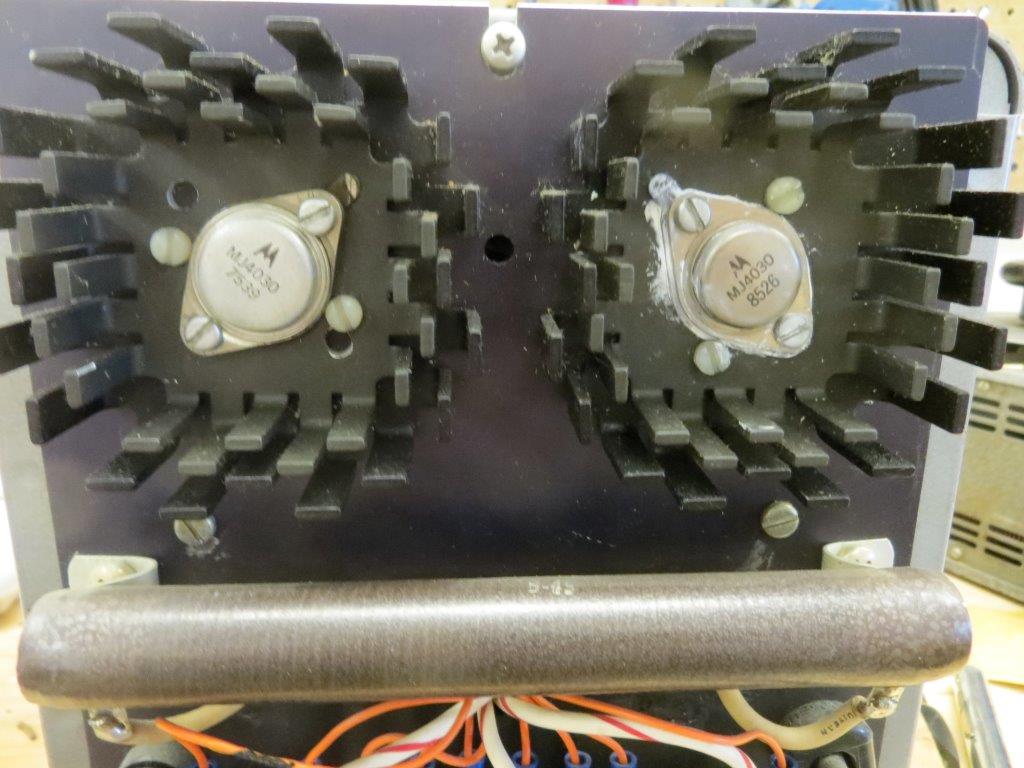

You might want to study the circuit I used about 40 years ago when I built my first PS. It uses a series parallel arrange with a hefty power resistor. The power resistor takes all the hell from the heat while the transistors stay cool, calm and collected. The documentation and circuit is included for your edification. From the picture, can you see where I goofed in applying this circuit?

Neat approach; there are always differnt ways to do a circuit. Never used the series configuration for power supplies but I can see that approach would be especially good if you were dealing with higher voltages. I did use series transistors in my scope days when HF high voltage transistors were not availabe- used four trans in a long-tailed-pair arrangement to generate 200V differential for driving the x plates of the tube.
That's not a goof- it's holes for extra cooling- done same thing many times. Why they made TO3 cans asymetrical I'll never know. The TO220 etc were so much better but not such a low thermal resistance. My favorite is the TO247 with a clamp on the top.

The nylon bolts melted ?
Hi Grand
I never trusted nylon parts on power trans. For one thing you can't get enough pressure for good heatsinking. But OK in this application because, as Ratch says, power trans run cool.

Not so far. The heat sink gets warm, not hot. The nylon is a good electrical insulator, too. The nylon bolts hold the two heat sinks together. The transistor is fastened with metal bolts.

Yes, a bench linear power supply. Had it for a long time now.
I should have put the dissipation resistor on top of the heat sinks so the warm air from the resistor does not go through the heat sinks.

Two things about the PS2 schematic.
1. What is the reason for two back-to-back Schottky diodes on the output (D2-4 (typo) and D2-5), especially when there already is one (D2-3)?
2. The current limiter R8 and Q2-3 introduce a voltage drop that varies with output current into the output voltage, significantly affecting the overall circuit regulation. If you move the current limiter to the collector of the output darlington (adding a PNP sense transistor), it will not introduce this error into the normal mode regulation.
ak
Hi Analog,
(1) The two back to back diodes are transorbs for transient voltage supression. Can't remember the part numbers but they are like zeners, but short once the threshold voltage is reached. They take hundres of amps for a short time. We used them on every outside word interfaces on some equipments. Our spec was to protect from the human body model for transient voltages which, if I rember correctly. was equivalent to a 100nF capacitor charged up to 4Kv.
(2) Fully agree about the voltage drop of the current sensing resistor but it is not my design it was the basic circuit arrangement for a simple power supply, way back. PNP transistors- you young fellows are spoilt these days. At the time pmp transistors were rare and frowned upon. But the other thing is that this starving current limiting approach is well behaved and doesn't get into a tange where the voltage and current servos fight themselves.
You dont like the circuit then. Give you a clue- I think it is pants.
The protection diode introduces another error. So in total the errpor in the voltage servo is (2* vbe )+ (Iout*Rsense) + (Dp Vf) : not good.
Not only that, but the voltage reference is hopeless: 18V zenners are poor: 4V7 to 7V5 better. so you would use a stack of zenners to give aroun 18V. The power supply ripple and dv rejection is awful. And the tempco couldn't be worse.
I never used the cicuit myself but it appeared all over the place at one time. My sole objective with this post was to demonstrate how a simple circuit is made much more complex when all the protection etc is added. Also to address throbscottle's problems with the output tran blowing with this very circuit.
Me, I'd use an LM317/337 with current booster trans if necessary, or perhaps one of the LDOs which are quite good.
Also, I made a precision lab PSU but that is another story.

1. I'm very familiar with tranzorbs. They have a semi-standard schematic symbol that is different from both the Schottky diode symbol on the schematic and a zener diode that they resemble. Also, tranzorbs are restructured zeners, optimized for large current peaks and transient thermal events; they do not short when the threshold is reached.
2. I was talking about a PNP signal transistor, not a PNP pass transistor. You're old - think 2N404 or CK722. And the other thing - I was not suggesting servoed current limiting, just the same starving approach reworked.

About the circuit: as I said, it is only symbolic and its design/performance are not relevant here.
But as you are obviously interested, I would more of less do what you say but also add a long-tailed-pair to elliminate the out-of-loop errors, get more gain, and better temp performance.
About the Transzorbs- I realise now that I put two Schottky diodes in rather than two Zeners. I couldn't find the symbol for a Transzorb in the library and I was in a hurry. Transzorbs, as you say, are a form of Zener and do not fold back.
