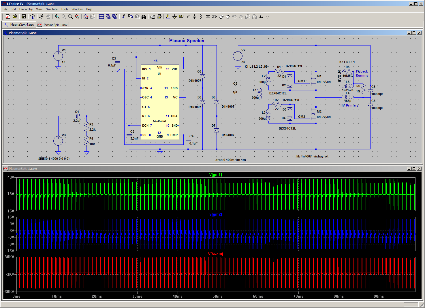

I can't get the SG3525 to oscillate. I don't remember how to look at a sub circuit but I think it is past time to see if the DG3525 was built right.
I was thinking the same thing, but didn't want to say it. However, I can't explain the work being done with M1 and M2? 206 Amps should blow them up. I'm not sure what's happening?
with R and C the osc should work. It does not. With out a ramp on 'C' nothing will work.
It is dead. I can see some ringing in the transformer at power up. I lowered the Q of the transformer and the power up ringing stopped.
Maybe some one can remind me how to edit a sub circuit and we can see how the 3525 was built.

Found a problem. You have a timing cap of 0.0033F and you want 0.0033uF. That is why the osc is not happy. It is still not happy but better.
Also you have some 0.1F caps. They should be 0.1uf
I just found another problem. Your timing cap has 220 ohms. I was looking at the ramp and said to my self 'looks like there is a resistor in series with the cap' and I clicked on the cap and there it is.
Also all your little caps around the IC have the same resistance. Remove the resistance and the osc functions.

I did it, it's oscillating.
Rev.4.4 I don't know if any work is being done or not, but I finally see oscillation.

C6,7,8,9 I changed to 47uf 170m ohm. It is taking a very long time for the design to 'converge'. Power supplies do not operate right for some time after power up. By changing to 47uF it takes 5mS for the supply to stabilize. There is too much ringing in the LC so I reduced the Q. C6-9=170m ohms and HV primary =50m ohms. Other wise it takes millions of cycles to see how this thing will operate.
Also I connected the top MOSFET-gate.
It is operating how I think it should. Probably should have diodes on "outA" and "outB".
KV,

Your top MOSFET has the gate connected to S. It does not work. The way you have things the voltage on C6,8 will drop to zero (slowly). This will stop working when the voltage approaches zero.
I connected the gate (again) and it seems to work.
If you want more voltage change L5 to 1.65mH.
Hey, Ron both MosFets were connected on source like that, alec_T had L5 at 10mh, I'll play around with the values.
Thanks for the catch, I keep using old drawings and didn't catch the flaws.
