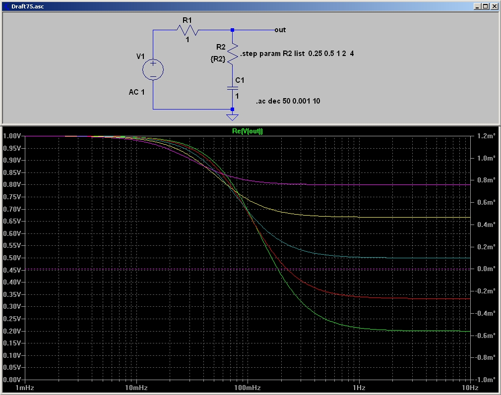

I have a low pass RC filter that looks like the attached picture https://tinypic.com/view.php?pic=1z6bo8p&s=8#.VEMc58mURyN
I have to derive the DC gain, the zero frequency, the pole frequency. I don't quite understand how the resistor R2 acts in this circuit.

I'll let you build the equations. However, they should describe this behavior: (normalized for 1Ohm, 1uF, and the ratio of R2 to R1.) Note the low freq gain. Note the high freq gain. Note that the frequency response follows from the ratio of R2 to R1.
Okay so this is my attempt at building the equations. I just want to see if I'm making the correct correlations.
A regular usual low pass filter has a transfer function of Vo/Vin= 1/(jωRC+1)
Now my low pass filter has a transfer function of Vo/Vin= R2/Rs (1/jwRsC+1)
where Rs=R1+R2
which would mean the cutoff frequency would be fc=1/2πRsC
Does this mean that once I pass my cutoff frequency my transfer function becomes R2/(R1+R2)
The function R2/(R1+R2) is a constant function, so this is a little unusual, but assuming that your transfer function is really:
Vo/Vi=(R2/Rs)*(1/(j*w*Rs*C)+1)
then the magnitude is:
(R2/Rs)*sqrt(1/(Rs^2*C^2*w^2)+1)
and we can see the factor:
as w gets higher and higher eventually becomes:
sqrt(1)
which of course equals 1, so we end up with:
|Vo/Vi|=R2/Rs=R2/(R1+R2)
At the cutoff frequency however the magnitude is:
(R2/Rs)*sqrt(2)=sqrt(2)*R2/(R1+R2)
and to reach within 1 percent of the final response we have to go to a frequency:
w=100/(sqrt(201)*Rs*C)
and then the response is:
1.01*(R2/(R1+R2))
but that requires a frequency that is:
w2=100/sqrt(201)
which is about 7 times higher than the cutoff frequency.
So yes it does approach that constant response, but only after a certain frequency has been reached.
